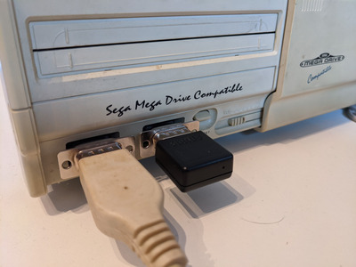

I've also found a workaround for a previous frustration with not being able to use my modern 8bitdo and retro-bit wireless megadrive joypads as the wireless dongles are too wide to fit into the recessed controller ports on the MegaPC! AmigaKit sell some handy A600 joystick port adapters which work great to bring the port out from the recess so I can attach the dongle. http://amigakit.amiga.store/product_info.php? … roducts_id=1246
The attachment wirelessdongle.jpeg is no longer available
One thing I did think would be sweet would be getting all the DOS games Sega released up and running on the machine and packaged up, they seem to be available on various abandonware sites. I've grabbed a few already and will make an attempt at getting them running at some point.

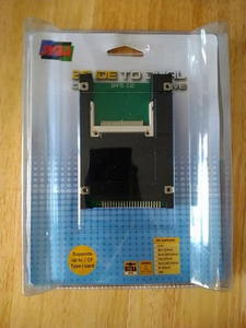

I've currently got two 512MB CF cards running on the IDE port - it does seem very sensitive to the adapter and CF card, and because of the BIOS you can't use a CF bigger than 512MB. After a lot of testing a lot of different adapters I ended up only having success with this adapter:-
The attachment DSC_2499.JPG is no longer available
It's currently running with 2x512MB Kingston cards. The only minor niggle is it requires you to use a 44pin to 40pin (+power) adapter cable, but it does seem to work very well and fits in the HDD bay very nicely 😀
Well done on that workaround for the joypads that is a very neat solution and makes it easier to unplug things - hope someone smart finds a way to install a dongle so it was flush so that you could slide the door shut without dongles/cables getting in the way !

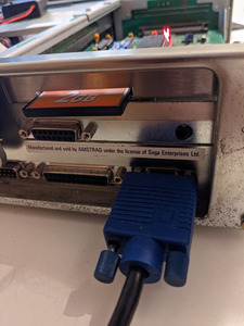

the Mega Card is now a thing 😁
it was made possible with megadrive guru Tiido's help
so what is onboard?
  • ALS100 soundchip providing SB/SBPRO/SB16 compatibility
  • a Yamaha OPL3
  • Realtek 8019AS ehternet controller providing 10mbps connection and boot rom support for XT-IDE BIOS
  • a scandoubler that makes possible for the onboard megadrive to output a standard VGA signal (it is a linedoubler like old amiga scandoublers, no framebuffer no lag - 1 scanline delay) , has jumper to enable/disable scanlines
  • an optional exclusive Serdaco MIDI daughterboard - the X3GS (basically same as X2GS but green and has some leds for added bling 🤣)
  • ISA header and MIDI I/O + routing configuration for an upcoming PCMIDI upgrade daughterboard , there are 2 midi jacks on board: 1x OUT and 1x IN/OUT selectable via jumpers
The ALS100 is a nice chip (and rare/expensive for some reason) but it cannot escape it's budget card roots. Rest assured this is the best sounding ALS100 card out there but do not expect quality to blow your mind.
It goes hand-in-hand with the Mega-PC that is a noisy and crammed system 🤣
The chip does support all SB ADPCM modes so there are no missing sounds in older games that use them.
The onboard Amstrad Adlib needs to be disabled with a simple mod - else the ALS100 software will complain about Adlib ports being used. Completely optional one can ignore that and edit ALS.INI by hand if needed.
The megadrive sound is routed through ALS100 so no separate speakers or external connections needed.
The scandoubler portion is now as good as it gets with the signals it gets from the original amstrad megadrive card - which is a little messy: video signal routing is not good and RGB levels overdriven.
Despite that, the photos below do not do it justice: at times one might think it's an emulator running and not the actual megadrive.
The ribbon cable from the amstrad megadrive card connects to Mega Card and then a new ribbon cable connects to the Amstrad motherboard. This way the original VGA port is used and A/V switching is done on the Mega Card.
There will be research how to mod the original amstrad megadrive card to bypass it's shortcomings: it will be quite some components removed but if someone wants to get the max quality out of it then it will be an option.
A small cable is needed to patch the megadrive clock to the scandoubler, this cannot be avoided and will look like this , solder points are 2 legs of the crystal oscillator...
and here is how the card connects to the system:
and now some pics of the card in action 😀 keep in mind I cannot take good CRT photos for the life of me, my camera has especially troubles with color balance 😐
that's it for now! hope you like what you see
I saw your post in the Amstrad users FB group. As I said there, totally awesome! The scanlines already look great even in the photos. I think the way you have made it so it can still use the original VGA and IDE (I assume?) Is perfect! You have managed to get so much functionality out of one ISA card. Its a labour of love for our Mega PC's 😀 Big thanks to you and Tiido for making this happen!
I must admit i've been away from my Mega PC the last few months with it being summer. I got it all loaded up with games and had been playing and enjoying Monkey Island 2, Wing Commander, wolfenstein and Commander Keen to name a few. I look forward to having more decent sound, ramming a high capacity disk inside, being able to connect via network and seeing glorious scanline MD output with The Mega Card 😀
I have a question... will the original Game port still work when adlib sound is disabled on the MD card?
