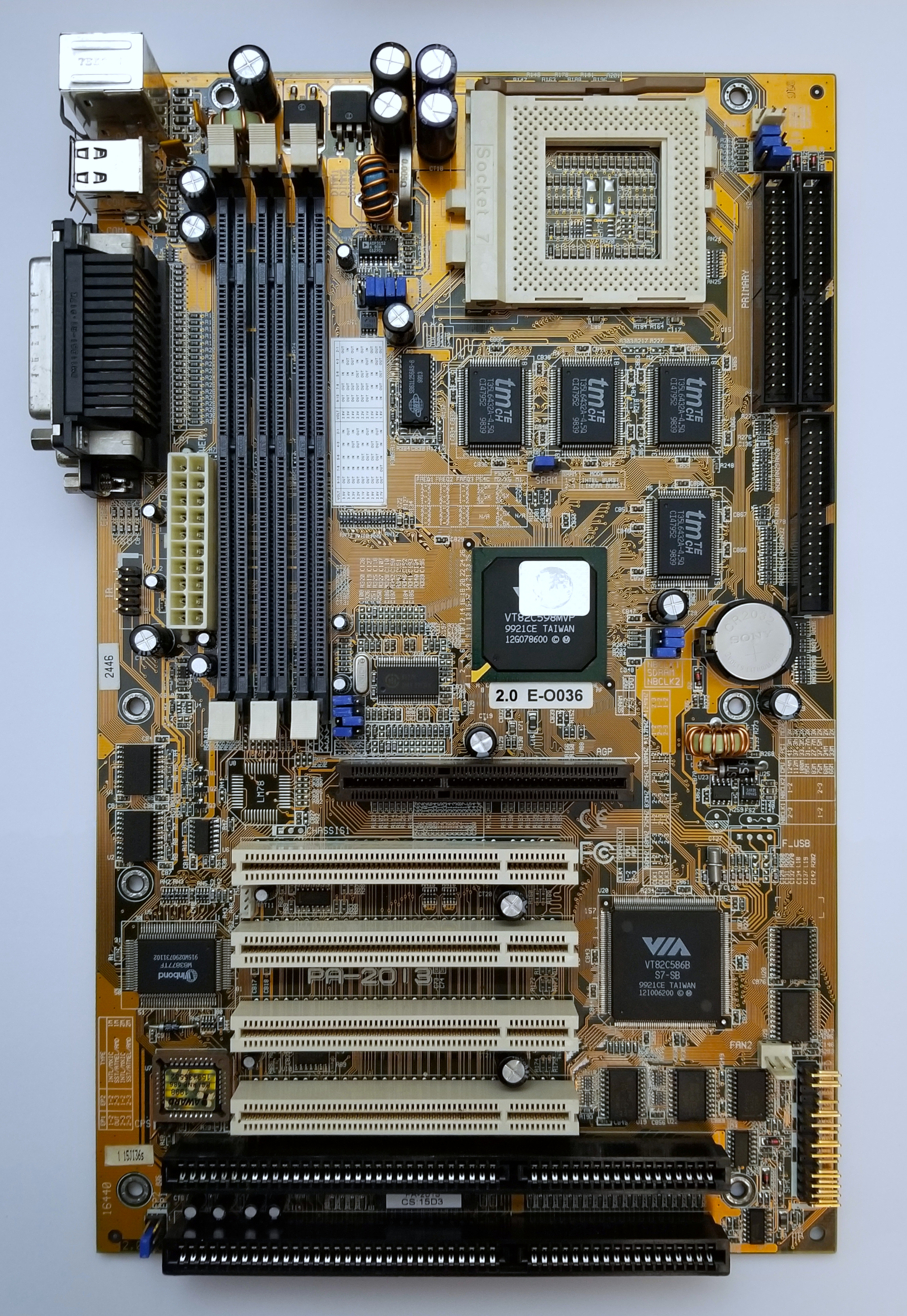

It could still be something to do with instability. The on-die cache could be catching errors and correcting them.
Can this be prevented by the disabling the "L2 ECC cache checking" option in bios?
Reply 281 of 638, by cyclone3d
Yeah, and that should theoretically also give a bit of a performance boost as well.
Not sure if that setting is only going to affect the motherboard cache but I'm guessing that that is the case.

The BIOS may be messing around with the ram timings etc when you call SetMul to change the multiplier, try setting multiplier to 6x and 5x with jumpers etc and run the benchmarks without running SetMul?
Reply 285 of 638, by pshipkov
mobo has no listed jumpers config for 6x, but with 3 jumpers in place it is probably available. needs to be verified.

Reply 286 of 638, by cyclone3d
pshipkov wrote on 2021-10-12, 23:55:
2x is 6x for AMD chips.
Yamaha XG repository
YMF7x4 Guide
Aopen AW744L II SB-LINK
Reply 287 of 638, by pshipkov
I see.
Ok, jumpering the multiplier produced results that make sense.
So either setmul.exe does something else in addition to adjusting multiplier, or BIOS is quietly trying to be smart about.
Thanks.
retro bits and bytes | DOS media library

Reply 289 of 638, by pshipkov
Thank you.
This is what i got so far:
The attachment 1.png is no longer available
K6-2+/550ACZ @672Mhz (112x6), default voltage
L1/L2/L3 caches enabled
Quadro2 Pro, Detonator3 7.58, graphics perf is CPU bound, OC the video adapter has no effect, moving to later GPUs has no effect.
System feels fully stable (inconclusive), but at 112x6 DRAM/CACHE timings cannot move an inch above their default values in BIOS.
I can get that 3D Mark 2000 number to ~3800 with compromised stability.
112x5.5 with tight cache/ram timings produces 3850 points without compromising stability.
Screenshot in my previous post.
Need to check more thoroughly 124x6 with on-board cache disabled.
3D Mark 2000 number goes to ~4000 - give or take a few.
Looking at the numbers posted around - feels like a slow board.
Still, i kind of like it, but that is my only SS7 experience so far.
What do you think of it ?

Here is what i got - crisp:
1Mb 4.5ns on-board cache chips. At 133MHz FSB with external cache turned-off board is still flaky.
I have 2 K6 CPUs only. The better one is K6-2+/550ACZ.
It can tick in the 600-700MHz range with default voltage and on air cooling.
Past 700 i put Peltier on top, but the CPU does not need it really. Voltage is 2.1
At that speed the board gets very fussy and is the limiting factor.
This FIC PA-2013 board is ok, but its perf does not wow me. It is cool 1500 3dmark2k points behind what you shown couple of posts above.
Tried the WPCREDIT and twk153b. Squeezed few more quants of perf at the expense of worsened stability.
Tried with external cache on/off. On is better.
