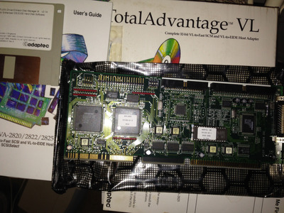

I have such a card I planed on using in my 486 build, but my alaris cougar already has this controller integrated on board so it's just sitting in storage.
PS the Appian ADI/2, CL-PD7220, AIC-25VL01 is all the same chip. They all can use the same drivers.
