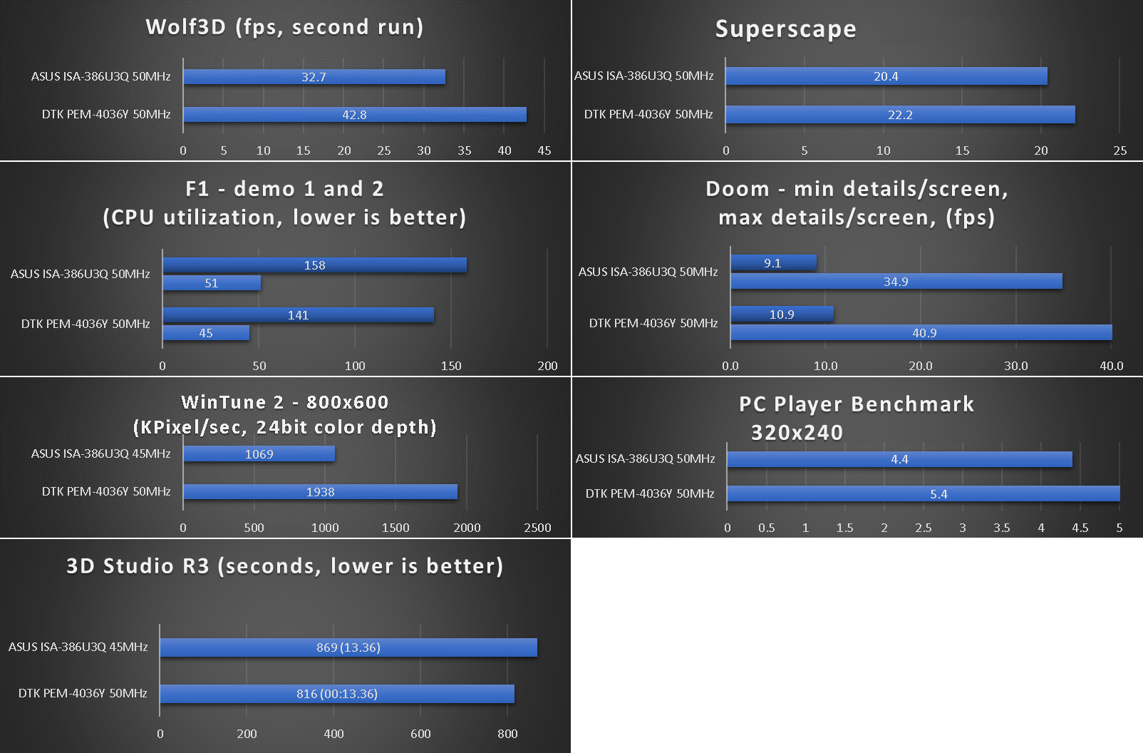

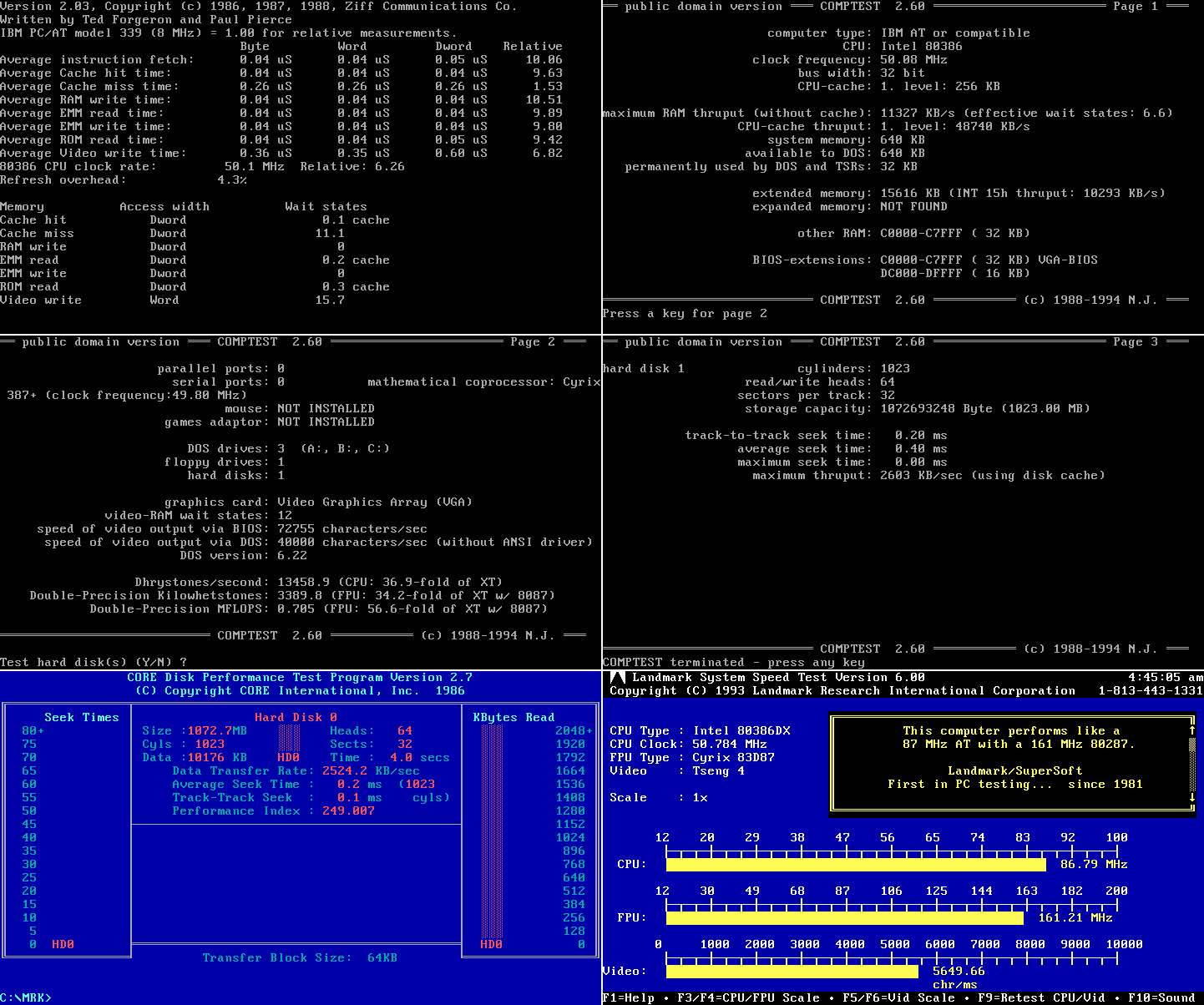

pshipkov wrote on 2020-07-13, 08:31:
I am going to dump here info about few more motherboards and other stuff. […]
ASUS ISA-386U3Q
An old new stock. Squeaky clean, manual, wrapping, etc.
This seems to be a 1993 model. Visually the motherboard looks great - tight and well organized.
There are pretty much no jumpers on it. There is one for the FPU, 2 for the cache configuration and that's pretty much it.
The BIOS lacks any sophistication - there are 3 parameters related to performance that can be set to "fast" or "slow".
It is a bit picky about memory. Had to try few different sets to find the right ones for it.
However its biggest drawback is the inability to handle properly CF cards. Concerning.
As a workaround i strapped a SCSI adapter and all was fine from that point.
The SCSI operates at 6.7Mb/s, which is not exactly stunning for 50MHz FSB.
The board overclocks to 50MHz with FPU and things are stable for DOS gaming, but for 3D rendering and in Windows i had to step down to 45MHz for complete stability.
https://www.petershipkov.com/temp/retro_pc_im … _isa-386u3q.jpg
Didn't bother running LightWave3D rendering test. It takes about 3 hours to complete and won't reveal anything surprising.
Conclusion:
I had high hopes for this motherboard, but it didn't quite hit the mark.
Issues with RAM, issues with CF cards, performance is so-so.
Otherwise it is a real looker. Not sure if pictures give it a justice.
