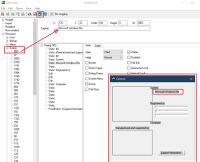

Installed Windows 98, rel. 4.10.2222 A,
My Computer -> General shows:
System:
Microsoft Windows Me
4.10.2222 A
Is this WIN98 or ME then?????

Reply 6 of 12, by dr_st
SpectriaForce wrote on 2022-01-11, 01:33:
This happens when you install nusb36. I'm still trying to figure out where I can change it.
What if you restore the original SYSTRAY.EXE, USER.EXE and USER32.DLL after installing NUSB36? I used this approach to allow NUSB to run on different languages which did not have an 'official' NUSB release.

Reply 8 of 12, by Joseph_Joestar
FYI, if you use the older NUSB 3.3 version, this won't happen.
Reply 9 of 12, by SpectriaForce
Joseph_Joestar wrote on 2022-01-11, 12:35:
That seems to be the case indeed. I have reinstalled Windows 98SE, installed the Windows 98SE USB drivers from my motherboard and USB card manufacturers (and rebooted), then installed NUSB 3.3 without removing any drivers or devices (unlike what the developer recommends) and then rebooted with a USB stick in a USB port so that NUSB detected the mass storage device and installed the driver for it. When I look at system properties Microsoft Windows 98 Second Edition is still being displayed. Very weird (I have not installed an unofficial Win 98SE service pack).

Reply 12 of 12, by 1541
RichB93 is absolutely right.
Opening the SYSDM.CPL with an editor like "eXeScope", you'll see where it comes from.
You can of cource edit it there as well, but it's just cosmetical issue...
