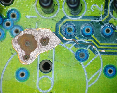

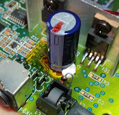

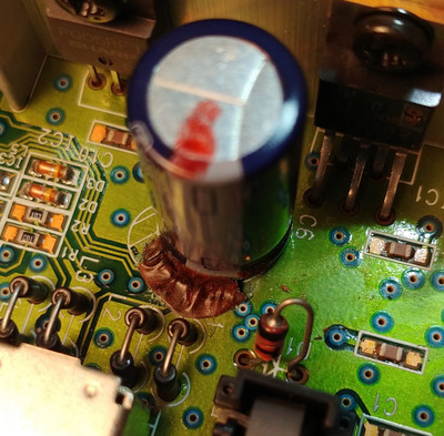

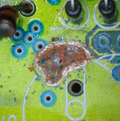

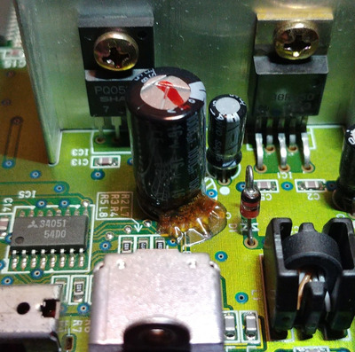

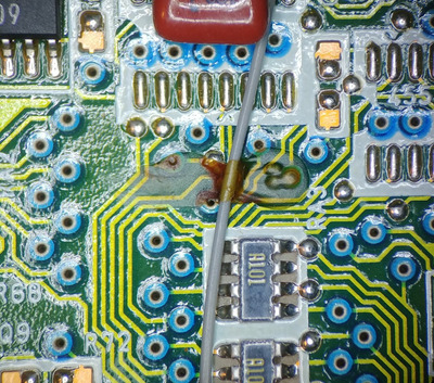

While examining my Roland Sound Canvas SC-55mkII while investigating a broken MIDI socket I spotted what appeared to be some minor corrosion around the DC filter capacitor. I might have ignored it completely had I not seen an episode of Adrian's Digital Basement where he discovered an adhesive that turned corrosive and destroyed part of a PCB he was repairing.
Unlike other adhesives I've seen used to secure large capacitors which remain somewhat pliable, this one had hardened and begun to crack. I don't know if this is a result of the chemical composition or its exposure to high temperatures near the VRM circuitry but it can be identified as an opaque dark brown that is consistent in color throughout.
After removing the capacitor and scraping away the adhesive, I found that the area underneath had become discolored with bits of corrosion just barely visible. While the board still looked serviceable on its face, whatever reaction had taken place had penetrated the lamented surface and begun to dissolve the copper ground plane underneath as well as some nearby traces.

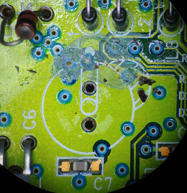

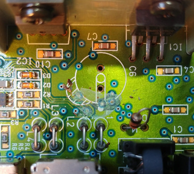

Reply 1 of 34, by Kahenraz

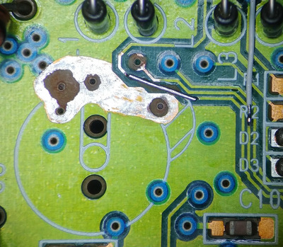

The surface had corroded to such an extent that applying only a minor pressure with the dull tip of a probe would cause it to crumble. To prevent any further decomposition, I scraped away as much of the surface as I could, revealing large gaps where copper had simply disappeared.
While cleaning the area, I could feel my probe fall through the surface where a nearby trace should have been and glide along its path like an empty trench.

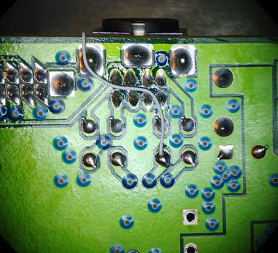

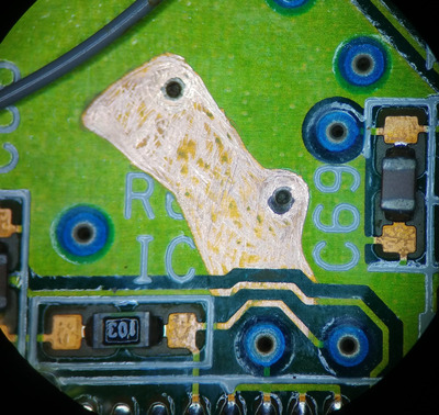

Reply 2 of 34, by Kahenraz

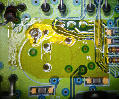

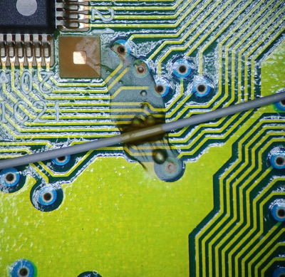

I bridged the broken trace using a resistor lead and applied a bodge wire to the trace next to it whose via had been destroyed. I also applied a bit of solder to the exposed copper to provide some minor defense against oxidation before covering the whole surface with a protective layer of Kapton.
I didn't have an exact match for this capacitor and it tested fine in my tester so I cleaned it off and soldered it back into place.

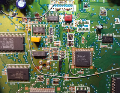

Reply 3 of 34, by Kahenraz

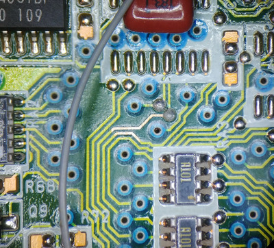

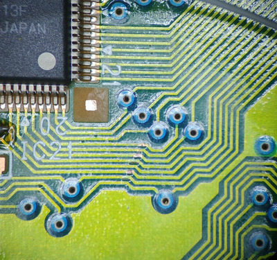

I noticed that there was a similar brown adhesive used to secure the bodge wires found on my mainboard. I decided to scrape all of these away on the off change that it was the same material but I think it was actually something different. Only one place appeared to have some very slight corrosion around a via and scraping away the mask beneath the entire surface of contact did not reveal any corrosion.
I suspect that when the PCB was passed on for rework it was performed at a station with a different bottle of adhesive that was not as corrosive or was something else entirely. The only similarity is that it was a shade of brown, however it was clearly translucent and not opaque like the kind used to secure the capacitor.

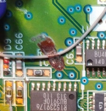

Reply 4 of 34, by Kahenraz
As an addendum to my previous observation, the bodge wire with adhesive which did had some corrosion was in fact opaque. The amount of corrosion was very minor so it's possible that heat plays some role in the volatility of its decomposition.
Notice how there is only as very minor corrosion at the via and the copper beneath the solder mask is intact.

Reply 5 of 34, by Kahenraz

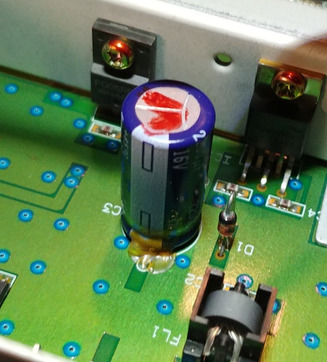

Despite the damage caused by the brown plague I found in my device, it was luckily isolated to a very small part of the board that was mostly ground plane with only two small traces being damaged. If this had been a multi-layer board then the damage might have otherwise been severe but this repair was thankfully very straightforward.
My Roland Sound Canvas SC-55mkII has been rescued just in time but I would encourage anyone with any Roland Sound Canvas to inspect their synthesizers to see if they have signs of the same caustic adhesive.

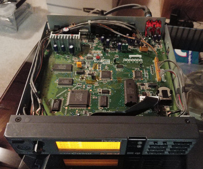

One further addendum. I inspected all of my synthesizers which include the following:
Roland MT-32 (old)
Roland CM-32L
Roland SC-55 (V1.21)
Roland SC-55mkII (V1.00)
Roland SC-88VL (V1.04)
Roland SC-7
Roland SC-55ST
Roland SC-88ST Pro
Yamaha MU-50 (V1.06)

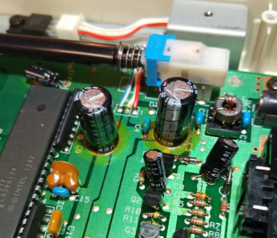

I found an adhesive used to secure large capacitors in the CM-32L, SC-55, SC-55mkII, and SC-88VL, however only my SC-55mkII of which I have only a single specimen exhibited this corrosive behavior. Even the SC-88VL which had a brown adhesive in a similar location with similar thermal characteristics was still pliable and was not corroding the PCB.
Unlike the adhesive in my SC-55mkII which was hard and brittle, all of the other adhesives were still somewhat pliable indicating a different material or composition.

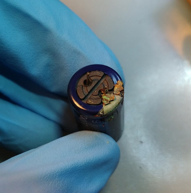

Reply 9 of 34, by darry
I wonder if the capacitor that was glued in the SC-55 might have leaked some electrolyte onto the adhesive and contributed to or even triggered/caused the issue .
Thank you for looking at all those synths .

Reply 11 of 34, by Kahenraz
darry wrote on 2022-01-19, 21:26:
The capacitor had not leaked and was in perfect condition. You can confirm from Adrian's video that the adhesive corroded in places where no capacitors were present.
Reply 12 of 34, by Shreddoc
In my SC-55MkII, that adhesive on that capacitor had clearly burned up. Could see the evidence of combustion when I cleaned it up, the carbon residue of scorching. The leftover adhesive was a harder, darker, very brittle remains which chipped off easily.
I agree that the range of special problems exhibited by that particular capacitor('s adhesive) in that particular device is likely heat-related.
Note it's close proximity to a heatsink.

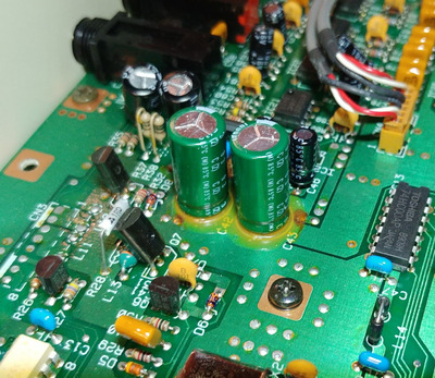

I just checked my MK1 and MK2 SC-55s , glue was there ofcourse but it did not cause any corrosion. I did remove it for good measure - IPA made short work of it 😀
MK1:
MK2:
Reply 17 of 34, by Kahenraz
keropi wrote on 2022-01-20, 15:17:
Do you have any before photos? The stuff that Adrian and I encountered was a dark brown with a consistent opaque color. It was also dry and hard.
If what you found was translucent then it was a different adhesive. I found this kind in my SC-88VL as well and it was fine.
What firmware versions are your SC-55 mkIIs?
Reply 18 of 34, by keropi
I only have one pic, both looked like this - indeed both had the translucent variant
my MK2 is 1.01
