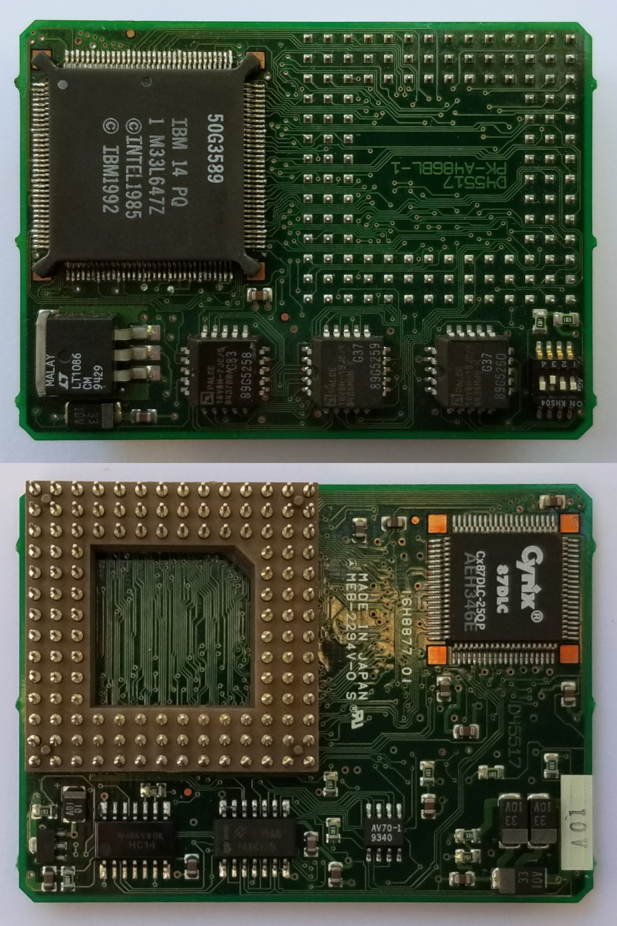

Finally found the motivation to pull that IODATA PK-A486BL3-1 386 CPU upgrade module which sports Blue Lighting 3 CPU and give it a spin.
The story here is that all 386 CPU update modules i know of are problematic in some way.
They don't work well on fast/good/late 386 motherboards - plagued by FPU / L1 cache / other stability issues, or no lights entirely.
This makes them largely useless since all the benefits they bring get wasted by the slow/early motherboards they work properly on.

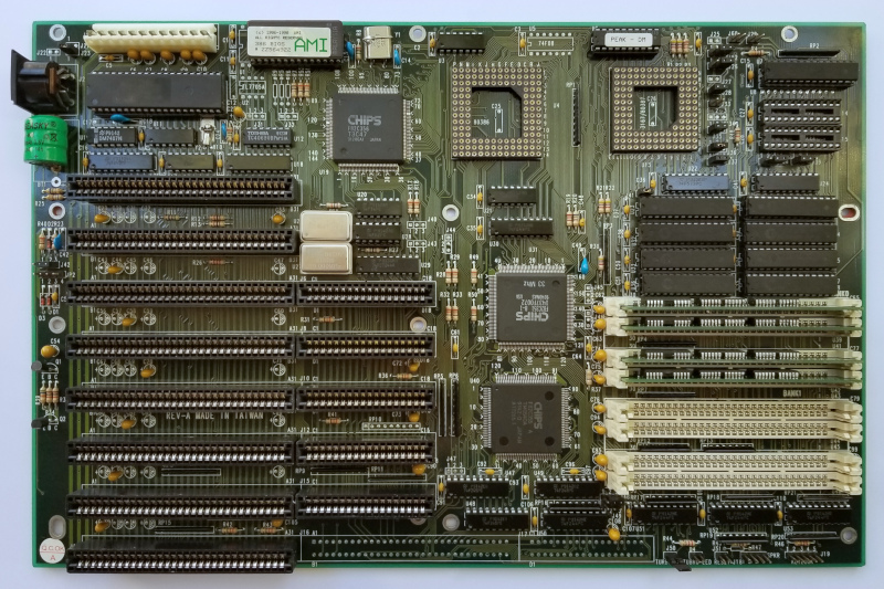

Which leads me to the motherboard in use:
Rectron Electronic Enterprises 386DX-33 PEAK DM
Based on Chips and Technologies FX82C351/5/6 chipset.
Simply put - it is a clunker.
Like the rest of those Electroglass, Peak and other mobos of the same type - wide PCB, low level of integration, slow chipset = very low performance.
The system cannot take more than 70MHz crystal oscillator, which results in maximum 35MHz CPU frequency.
There is a second crystal for ISA speed. It was 32MHz by default. Bumped it to 46.16MHz which improved performance. No lights past that.
The picture above shows 256Kb cache installed but had to run with 128Kb instead.
These type of boards require 64kx4 TAG chip to get you to 256Kb L2 cache.
I don't have 64kx4, so 128Kk it is.
ET4000/W32i and Cirrus Logic GD-5434 based video cards don't work on this board.
Used ET4000AX instead.

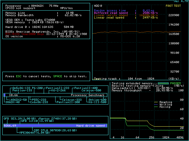

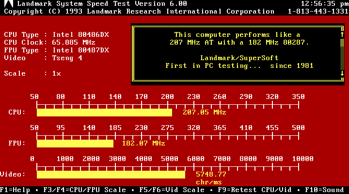

Here is what LM6 and SpeedSys say:
Working L1/L2 caches.
Working FPU.
Couple of benchmarked numbers.
Compared against DTK-PEM-4036Y + TI 486 SXL2CPU running at 50MHz natively (shared info in this post.
                 wolf3d     Superscape    PcPlayer    Doom
Peak+BL3 @60MHz: 35.6 fps 30.3 fps 8.3 fps 14.8 fps
DTK+SXL2 @50MHz: 65.4 fps 35.7 fps 9 fps 18.1 fps
(will try to swap this with the usual bars for better visual clarity)

Reply 1006 of 2161, by feipoa
I highly recommend going through the entire Revto486 manual published by Evergreen. There are literally dozens of register options and commands with walk-throughs for various conditions. I tested my BL3's years ago and the information is no longer fresh in my mind.
I also have dozens of pages of hand written notes concerning the Evergreen Revto486 driver, caveats, and settings for the CTCHIP34 utility w.r.t. the IBM BL3. It will take some time to go through all of them.
I've pulled out some of my notes on the IODATA module.
