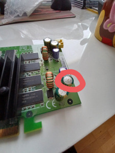

Hi. I received today a gpu put it in my systemand i hear some strange like electro burning noise and i could smell something burned. So turned off the pc. Looked at the gpu and one capacitor is done. The gpu ran for around 10 seconds.
Shall i expect maybe some further damage on the gpu or changing the capacitor ( and also all of that type) would be enough?
The gpu didnt show any screen at that moment.

If that capacitor has gone bad then it's likely that all other similar capacitors on the GPU are bad or close to going bad too. Plan on recapping the entire GPU, but start with the blown one just in case it is the only one that went bad.

Electrolytic caps can smell if they suddenly go pop. That is an unusual failure mode though. Did the seller advertise the card as working? Did it happen the very first time you tried it? If you inspect it does it look like there was any rework of the caps done already? What is the exact model of the card?
Reply 8 of 11, by atom1kk
The seller said it was ok. But it was only 17 euro incl shipping. He refunded me 10, so i ordered new capacitors. It happened immidiately as i started the pc. This one which broke was already bit arched, but i decided to try it out. Had many other cards where it wasnt a problem.
The card is a GF3 Ti 200 from medion
Reply 9 of 11, by Horun
The rest of the card should be OK once you replace the caps if that is all that is wrong. GF3 Ti 200's are a decent card !!
