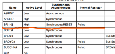

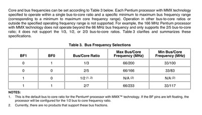

JamesF36 wrote on 2022-06-22, 18:45:
After fiddling around for many hours with this motherboard I think i’ve come to the conclusion this motherboard only goes up to 2x multiplier as it is … if I want 3x i’m gonna have to do some modification, but i’ve seen people modify their CPU to do the proper multiplier.. how is that done?
This is because you are using an MMX chip on a socket 5 board, which lacks the pull-up on BF0 that classic Pentiums normally have.
This effectively limits the max bus ratio which you can achieve without modifications. To fix it, you will have to manually pull up BF0 to 5V with a resistor (at least a few hundred ohms).

computerguy08 wrote on 2022-06-23, 15:03:
This is because you are using an MMX chip on a socket 5 board, which lacks the pull-up on BF0 that classic Pentiums normally hav […]

Intel specs the pull up at 2.2k or less but I’ve seen as low as 330 ohms used for pull up.
It seems that generally, you want your pull down to be 1/4 to 1/13th of the pull up rating (these numbers based on actual observations in field of what has been used)

Yes, I even said so, with screenshots from the datasheet. Besides the little voltage mishap, I don't think I got any other details wrong. I'm taking specifically about BF0 on the MMX, which has a pull-down internally and which can be fixed on Socket 5 boards with a pull-up resistor to 3.3V. Hopefully I made myself clear enough.
