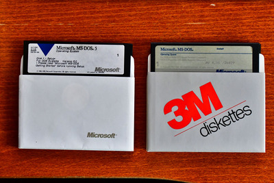

First disk of MS-DOS 5 is called setup, not start up nor install like MS-DOS 4:
286.59 KiB
1301 views
Correct me if I'm wrong.
It's unfortunate that I don't have an IBM PC anymore, but I would definitely like to experiment to see what the problem is.
Reply 4 of 13, by jakethompson1
SpectriaForce wrote on 2022-08-06, 18:34:
DOS 5 has an autoexec.bat that launches the setup program, and unlike 6, there aren't any keys you can push or hold down to bypass that. You have to wait for it to launch and then F3 to get out. So to debug further it'd really depend on whether it just hangs silently with a blinking cursor, shows an error message, etc.

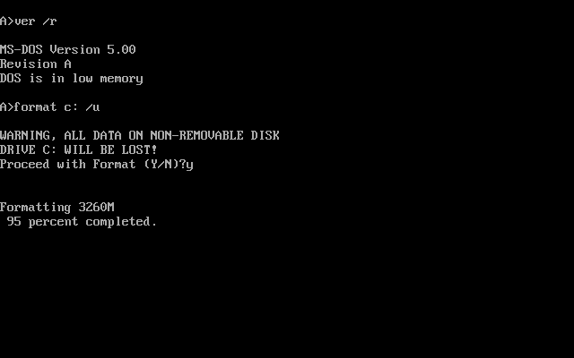

There were at least two versions of MS-DOS 5!
The exact revision can be checked with VER /R

Reply 10 of 13, by Grzyb
Jo22 wrote on 2022-08-07, 17:30:
+1 I second that. […]
+1
I second that.
"Formatting 3260M" in MS-DOS 5.00 ?
But how?
Sectors larger than 512 Bytes?

Reply 11 of 13, by MarkP
Grzyb wrote on 2022-08-08, 14:10:
"Formatting 3260M" in MS-DOS 5.00 ? But how? Sectors larger than 512 Bytes? […]
+1
I second that.
But how?
Magic wand maybe.
Reply 12 of 13, by Jo22
It's been a while.. There's a patch for that.
Technically, that should also work with MS-DOS 6.xx, but that didn't exist at the time yet,
so things must be done manually via hex editor.
