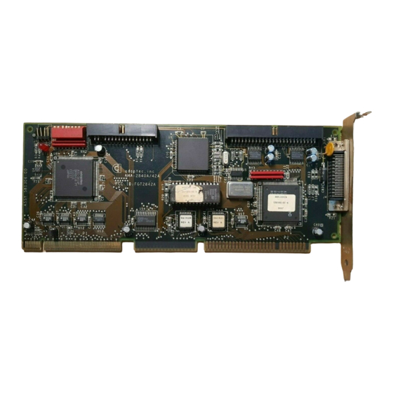

The harddrive was the real pain, the most problematic part.
I could have used the CF-adapter, but I wanted the real hard drive so wanted to play with SCSI. I was hunting for the VLB SCSI for a long time, until found the Adaptec2842A:
First, I spent a day trying to make it run at all. The problem was in a small jumper enabling the WB-cache (the motherboard doesn't support it).
Second, I tried to add support for larger hard drives. I used 18GB SCSI (68 pin via 68 to 50 pin adapter). There was an Adaptec BIOS patch by mkarcher (thanks him a lot), but I had different BIOS version so had to make my own patch with offsets of my BIOS based on his work.
And when I had all of it working and partitioned my hard drive it died 🙁 The problem with SCSI is that there are many hard drives with SCA-80 interfaces, even the new ones, of size 73GB or more that don't work on old 50-pin adapters. The simply don't have narrow/wide switch so SCA-80 to 50 pin adapters simply don't work. I bought 2 18GB drive with HD68 - one was dead initially and another one died few days ago - the motor tries to start and squeaks, though adapter detects the hard drive. The same was with 9GB drives.

SCSI CD-ROM is very rare guest here. And the best choice to me would be to buy the LMSI drive that is supported by PAS16 card but they are expensive as hell and even more rare. I tried 6x IDE and that's the best choice I could possibly find.
I like typical builds of a time - not very early ones and not the combines like VIP motherboards. And though I had Am486DX4 it always was poor man's Pentium.
As for SCSI drives... yes, I try SCA2 drives from spare parts, but they work only with SCA2 to 68 pin adapters to me.
As I understand, SCA2 to 50 pin either not work at all, or I need the drives of lesser capacity. There are problems with termination of unused contacts (and bus width on such drives that cannot be set).

Reply 8 of 16, by PC-Engineer
You need an adapter that terminates the upper 8Bit of the wide bus correctly (Picture 1 +2). Mostly it works without, but without termination there are refexions on the data lines, which some drives can handle and others not. Most SCA adapters (Picture 3) have no termination. The SCA drives have no jumper for SCSI ID and spin-on behavior, this jumpers are delivered by the adapter. At the end of the cable there must also be a termination (Picture 4) in any case. SCA drives and SCA-adapters do not have this!
So first try to get an internal SCSI terminator, like in Picture 4 and put it at the end of your SCSI cable.
As an option: most drives with 50pin (narrow SCSI) have the option for termination built into the drive. I.e. if you get a SCSI CD-ROM (narrow SCSI), you attach it to the end of the SCSI cable and activate its termination.

Reply 10 of 16, by rkurbatov
Surprisingly, one of the Cheetah's, 9Gb, 10K is working and even without the terminator. Formatting and surface test went well. Another one is dead.
But hell, how hot and lout it is. I afraid to put it into the case under the PSU.
I ordered two more 9G drives by IBM, also with SCA2, but they are 7200RPM so should be much more quite.

Reply 11 of 16, by rkurbatov
Today I threw in thrash bin all my bad SCSI drives. 3x73G, 2x18G, 2x9G, 1x36G. There were 2x4.3G last year. So 10 in total. Either media errors or broken motor - I hear clicking sound but spindle doesn't start rotation. I have 7 working and tested ones: 7 out of 17,  something like 40% output. Could be worse.
As I thought, IBM at 7200 is much more quite and cold than crazy Cheetah (though pretty loud anyway). I'll use two 5cm coolers and will drill holes in case backplate - that should be enough.
Interesting, that more modern 15K drives are even more quite and colder than old 7200 ones. Standard 10cm cooler on front panel should be enough to cool two 73G drives I'm going to use on my P4 build.

Reply 13 of 16, by rkurbatov
PC-Engineer, I have only one cable with terminator - it's 68pin. And only one device with builtin terminator - 50 pin streamer. Everything else just works fine (or doesn't work at all on any type of cable in any configuration).
I'm going to use 2 73GB SCA drives with terminated cable and for every other build I don't know what to do. Cables have only two connectors - one for controller and one for device and my 68 pin drives just work, so I'm nto going to do anything.

Reply 14 of 16, by PC-Engineer
Termination is mandatory for SCSI to function reliably. Starting from U160 (68pol) a termination at the cable end was usual with SCSI. These cables and terminators are I downward compatible. If you run the drives on this cable, it is perfect.
