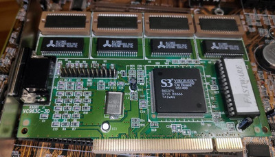

So I will keep it short - I am purchasing Fastware S3 Virge DX 4mb PCI VGA VC963C-3D, and I will also for sure purchase a Voodoo kit, just to get it before it's gone.

That is, as stated, the plan - I must admit that seller went out of his way to show the working state
Here are some images for proof and validation:

Reply 19 of 21, by damjank
mkarcher wrote on 2022-10-11, 00:06:
damjank wrote on 2022-10-10, 18:33:
Though overclocking is not my intention - is overclocking referring only to the 3D engine - I would imagine that overclocking will do little for VGA/SVGA performance...
Overclocking will make the chip access the memory faster. This will directly make the accelerator faster. It will also allow higher bandwidth transfers over the PCI bus, assuming you are not limited by the PCI bus or processor frontside bus. As it provides more total bandwidth, it will lessen the impact of the video display process on the available memory bandwidth, which is important if you run high resolutions at high refresh rates. But if high resolutions at high refresh rates are your primary priority, the ViRGE/VX might be worth a second thought. I doubt overclocking will make a directly observable effect unless you use 3D acceleration, but you should definitely be able to see overclocking effects in synthetic benchmarks. I, for example, made a primitive low-level benchmark that uses the accelerator engine from DOS and benched how fast big solid rectangles of a constant color can be drawn (the easiest task I can assign to the accelerator), and measured that (at least during filling each line) the memory can be completely saturated by the accelerator if you turn off the display refresh.
When you overclock from 50MHz to 75MHz, you get 50% more accelerator performance with scanout disabled. With scanout enabled, the win might be even higher. Of course this requires sufficiently fast RAM.
So overclocking, also for DOS, comes to play with DX cards then? If I am sticking with low resolutions, let us say 800x600 and 1024x768 at max 8also with 3D using Voodoo cards), then VX is too much trouble. Also, there might be some really old games in play that may pose issues to it.
Any other thoughts on the card purchase plan - it looks like this now:
either going with DX card: AOpen PT70 PCI Grafikkarte (S3 ViRGE/DX, 86C275, 4MB, 1997) or Fastware S3 Virge DX 4mb PCI VGA VC963C-3D depending on which card is still available now
or go with an older setup using Chaintech GP-5446 PCI Grafikkarte (Cirrus Logic CL-GD5446, 2MB, 1996) or Ark Logic ARK1000PV 1MB RAM depending on which card is still available.
I understand, that VGA core performance (at least in DOS) should be sufficient with all of them, the only real drawback would be Windows 95 2D performance, if at all.
3D will be provided only by Voodoo 2 cards.
Rest of the cards, I will take off the table for now, I think.
