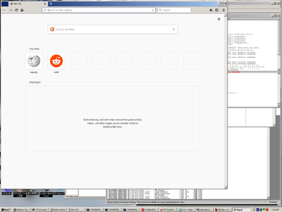

I just snagged the initial (unstable) release of the new MyPal 68. This is a FireFox port for WinXP.
I use Windows 2000, so I went in with CFF Explorer and patched some missing imports in MOZGLUE.DLL and XUL.DLL with bogus ones. This was enough to get it running.
CredReadA -- CredFree
CredWriteA -- RegCloseKey
NtReleaseKeyedEvent -- DbgPrint
NtWaitForKeyedEvent -- DbgPrint
It's foggy outside so my net connection is very slow... but so far the browser seems to be quite functional (posting from it right now).
