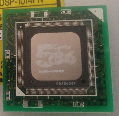

So I got a 5x85, stepping 0, revision 5, more specifically a 100QP variant (The laptop chip, soldered on an interposer).
For all test, the chip is overclocked to 120Mhz.
The motherboard is an Acer A1GX-2 (with Ali 1429G chipset) with registry patched for fastest memory and 0 WS for the cache.
On DOS I made two config :
* All enabled except LOOP
* All enabled except BTB (some DOS application don't seam to like BTB)
On windows, I run it with everything except LOOP, RSTK, BWRT, and DTE.
You are right about stability going away (probably with heat?). But after testing I noticed that I don't need 3.85v. The chip is totally happy with 3.45V.
Once I switched to 3.45V, the stability issue went away (I think). So far the system is playing 320kbps MP3 non stop since about an hour (With 3.85V, it fail after less than 10 minutes).
I can still make it crash if I load the CPU to 100% and do a LOT of task switching (upload stuff by FTP while playing the 320k MP3).
From what I read before I did not expect that chip to be fine with 3.45V while overclocked at 120Mhz, but I suppose the QP variants might be higher bins as they are supposed to be in a (usually badly cooled) laptop.
Chip won't post at 150Mhz (at least not at 3.45v or 3.85v).
There is one issue on that motherboard with this CPU running 120Mhz : The board don't set the proper AT bus clock by default with mean one time out of two, pressing a key will <beep> in the BIOS / bootloader / dos boot menu. Also the bootloader will fail to initialize A20 and crash one time out of two.
But once it boot, chipset registers get patched, including AT bus, the issue go away. I use fastreboot that come with QEMM so registers stay patched on reboot (if I want to go in the BIOS without having a fight with the keyboard)

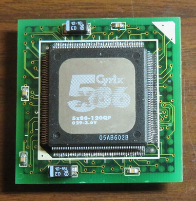

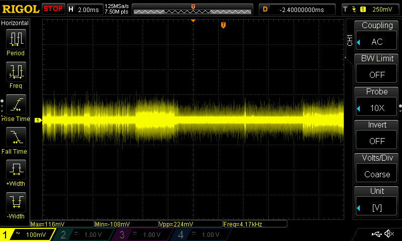

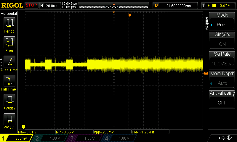

Reply 64 of 118, by feipoa
Where did you find your CPU? It is hard to find these QFP to PGA variants.
The Vcc rail on these PCBs is kind of noisy. You could try adding some caps to reduce this some. Might help with OC, might not. I used 100 nF for the smaller caps and 10 uF for the larger ones.
Here's mine:
The attachment Cyrix_5x86-120_QFP_1.JPG is no longer available

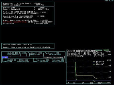

Reply 71 of 118, by feipoa
I doubt you will get 2-1-1-1 stable on this motherboard, but I hope I am wrong. You also need to swap about the EDO sticks to check for 2-1-1-1 cache stability. From my experience, the best sticks tend to have TSOP chips rather than SOJ.
Can you show your speedsys and cachechk screenshot for 3-1-1-1?
Is 3-1-1-1 still stable?
Attached are my results from 2011 at 150 MHz.
The attachment IBM-5x86c-Thinkpad_TP365E_Mod_1.jpg is no longer available
The attachment IBM-5x86c-150-Speedsys_1.png is no longer available
I don't recall what the L2 was set at. I was using FPM. Although ugly, these Thinkpad interposers allow for a very clean Vcc rail. Since then, I have about 10 interposers from China, but with only 6 locations for capacitors, their outputs aren't as clean. Something like 35 mV noise on the Thinkpad vs. 80 mV on the Chinese interposers.
Today my system ran for 5 hours straight, in Windows 98, later in DOS, and all without any problems.
So yes, it seems stable. I was also modifying the power regulator, so in the end I increased the voltage to approximately 4.10-4.15V. The previous regulator was probably better, but it was too big 😁
Just to be sure. These results are on a stable system, 3x50MHz FSB, 1MB 3-1-1-1 0WS cache and 32MB EDO RAM with the second best setting in the BIOS ("Faster" for reading and "Fastest" for writing)
I also attach a short video where you can see the active register settings. CPU-Z incorrectly reports the cache size 😁

BTW I recently designed a new interposer v2 with onboard VRM with fast response DC-DC switcher RT5789AGJ8F at bottom side. I hope it could improve Vcore clarity and maybe allows to lower Vcore a bit while keeping the stability. I'll use it for Am5x86 that is much less power hungry that this Cyrix 0,6um fat boy 😀
I measured Vcore on my Am5x86 under load on Octek Hippo 10 board (MB's linear regulator) and it's not so bad:
http://rayer.g6.cz/hardware/retropc2/hipo10d.png
http://rayer.g6.cz/hardware/retropc2/hipo10e.png
So I don't expect any miracle will happen with new VRM, maybe I could go from 3,7-3,8V to 3,5-3,6V @40MHz, 50MHz seems to be no go on that VLB MB anyway...
