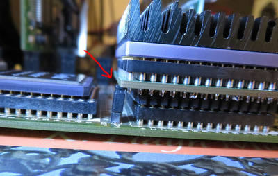

Sphere478 wrote on 2022-12-10, 03:02:
Looking at this closer, I can add more on the underside without much sacrificing also. Again, on the 5v though […]
Do you want more 5v caps?
Thicker pcb will mean less interference and suck pins in more.
It will also increase via resistance.
Give and take.
I think 1.6 makes sense unless 2.0 is same price and even at that, a toss up
Edit: managed to fit 10 5v 1210 caps above and below without much sacrificing of design.
Want all of em? Or take some out?
Aren't there traces crossing the bottom central region? If not, or can be moved, it sounds like a decent plan to put the 4x Vin on the bottom and 4x Vout on the top. Only one minor drawback to putting the caps on the bottom centre region is they will be more difficult to remove on/off for experimenting. Not a show stopper though.
10? lol. I think 4 Vin and 4 Vout are enough. It is really diminishing returns. I think best to stick with the values and quantities tested.

Reply 767 of 1229, by rasz_pl
feipoa wrote on 2022-12-10, 02:55:
Cost aside, would there be any benefit to producing the PCBs in 2 mm height so that the PGA pins won't stick as far down under the PCB? And if there are signal traces stacked on one another without any grounding between, could this extra thickness help at all?
no, and you should snip those legs flush after soldering, they do all act like mini antennas
>on the 5v though
10 caps on the input is pure insanity 😀

rasz_pl wrote on 2022-12-10, 17:28:
If looks matter none, I suppose. For a compromise, I think best to snip the legs before soldering them so that solder covers the snip marks.
10 caps on the input is pure insanity :)
I think so too.

Reply 779 of 1229, by feipoa
Is 1 M-ohm input impedance not sufficient for these measurements?
This is the interposer GND I've been using for the last little while and with these tests. It is as short as I could make it. Clipping two probe GNDs directly to the header was causing shorts with the adjacent 5V pin, so I had to use a connector:
246.06 KiB
851 views
I don't think I'm picking up a radio station because when I use a much longer GND to the molex, the waveform disappears/blurs:
244.2 KiB
851 views
