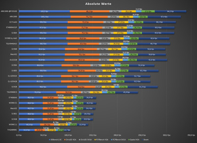

I made a comparison with various VLB cards on an Am5x86 @160MHz on SV2GX4, also with the S3 968 from Madao („by Matt“) with Spea BIOS (it has a slightly higher Memory clock i think) and the Diamond Stealth 64 Video VRAM.

The whole test description is here: https://dosreloaded.de/forum/index.php? ... enchmarks/

Very nice compilation. Do you have the Trio64V+ and S3 868 to include as well?
This was done with the Synchronize setting?
From your list, it looks like the Trident 9440AG, ARK1000, and Trio64 are fairly well matched in DOOM, but the SPEA still falls behind the Trio64 by 3.7 fps.

I have Trio64V+ too, but no S3 868. The S3 DRAM cards are a little Bit faster in DOS than the S3 VRAM cards. And the Trident 9440 is a very descent card.
The Tests were all done in transparent mode.

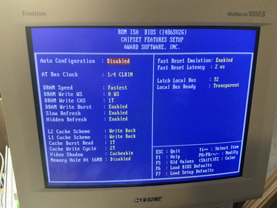

Reply 1567 of 2154, by feipoa
Transparent mode? That is curious. I was unable to get Windows 3.1 working in transparent mode with the Diamond S3 968 card at 40 MHz, L2-WB-1024K, 64 MB, L1-WB and tightest memory settings. Do you recall your system specs?
Since our S3 968 numbers match up, either your system is really in Synchronize mode, or mine is really in transparent mode.

My config was exactly that

But I didn‘t ran it in Windows while this test, only in DOS. I think the transparent Mode has no impact to some of the benchmarks - if i remember correct. Made this Test two years ago.
@40MHz the Diamond card sometimes has problems to boot up with the correct monitor frequency (out of range), so that i have no picture in BIOS mode and post screen. This effect is independent of transparent/syncronize mode.

Great info in the last several posts.
Thanks for chiming in PC-Engineer. Going to link your post to the directory of this thread.
I remember looking at your benchmarks before.
Noticing that i get slightly better perf with Ark1000VL on the same mobo and the settings, but slightly lower with Diamond S3 Trio64 than your Spea Mirage P64 VL.
Can you share its BIOS please ? Wonder if that will make a difference if i slap it on the Diamond card here.
Also, can you add numbers for S3 Trio64V+ based on Matt's design ?
It will be interesting to see where it fits.
Read the rest of your notes in the German forum - nodded at each one.
A small comment - CL GD-5434 ISA is the top dog in ... well ... ISA VGA/SVGA.
The 3 of you are the closest group to be able to provide an end-to-end overview of this S3 VLB business, despite each one is missing a card or two.
The missing link for me is how S3 Vision 868 (which according to WGS is faster than S3 Trio64) and S3 Trio64V+ stack-up.

Level 1 and 2 caches in write-back mode for best performance.

--- Am5x86 @160MHz (4x40)
All BIOS settings on max.

SpeedSys:
benchmark results
Not bad overall.
Best results in Windows accellerated GUI among all tested boards so far.
Lacks quite a bit in Wolf3D and Doom.
