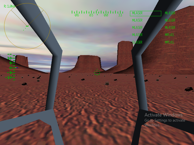

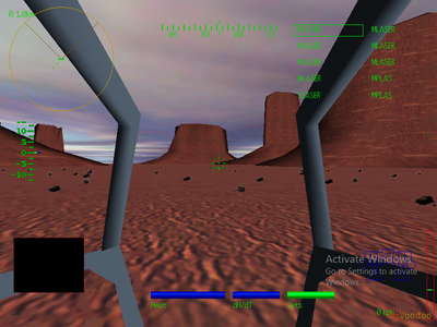

Reply 42 of 61, by BEEN_Nath_58
Continuation of previous post: Meanwhile, I managed to load up MechWarrior 2 with nGlide too but there are still problems. I attached screenshots to compare nGlide vs dgVoodoo1 vs dgVoodoo. There is yet another problem untold. When I abort a mission, the menu crashes in dgV2 and freezes to a black screen in dgV1 (also in nGlide).
nGlide:
file.php?mode=view&id=141093
dgVoodoo1:
file.php?mode=view&id=141091
dgVoodoo2:
file.php?mode=view&id=141092
Reply 43 of 61, by Gamecollector
BEEN_Nath_58 wrote on 2022-07-07, 05:13:
Try nGlide 2.00.

Reply 45 of 61, by Dege
You mean the HUD has suddenly become correct with dgv2? How can that be? (how could be wrong...)
Also, as far as I remember, the game didn't crash for me when returning from a mission to the main menu, or quitting to Windows.
Reply 46 of 61, by BEEN_Nath_58
Dege wrote on 2022-07-12, 12:08:
I wish I knew the answer, but the game behaves so inconsistent and absurd even ghotik struggles to just run the game on his PC. Regarding the menu, I think it's again a "you" problem in my part (games can't find msvcrt.dll and such even when they are installed and dosbox crashes in any programfiles folder). I think I will wait for my Windows reinstall and retest it.

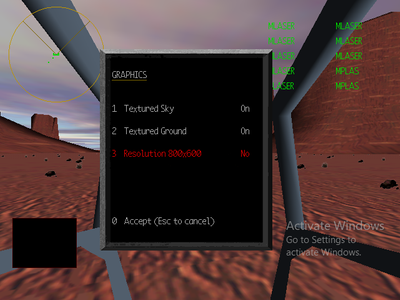

Reply 50 of 61, by BEEN_Nath_58
@Dege
And so I installed Windows 11 22H2 and guess what, the HUD now loads perfectly! Except there is one thing still left.
The game still freezes/crashes at a black screen after a mission exit. I installed the game as the first application after OTVDM, so it can't be anything else interfering.
Reply 51 of 61, by BEEN_Nath_58
BEEN_Nath_58 wrote on 2022-09-20, 19:23:
@Dege […]
@Dege
Oh wait the problem is still there:
file.php?mode=view&id=145941
The problem will arrive only if I enable Resolution 800x600. I think that can be fixed easily by you.
Also that crash after exit happens without DxWnd DirectX interference so it must be something else, maybe related to DirectDraw/Glide to GDI surface transformations... (the game GUI uses GDI).

Reply 56 of 61, by Dege
It's embarrassing but I finally found a bug in dgVoodoo. At least I fixed it (see WIP89.1), now it should work in 800x600 too.
Reply 57 of 61, by BEEN_Nath_58
Dege wrote on 2022-12-21, 20:14:
Yes it is working. Thanks, the problem is fixed.

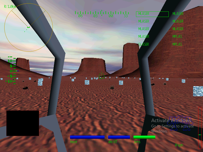

Reply 58 of 61, by BEEN_Nath_58
Back with this thread. I found yet another bug:
If I choose a resolution in dgVoodoo2, say Desktop, or 2560x1440, the HUD colours are messed up
Reply 59 of 61, by Carrera
