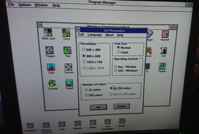

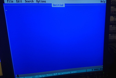

Got an ISA CL-GD5429 graphics adapter in my 486, connected to a 19" LCD monitor. Haven't seen the slightest trace of any jailbars so far. Running Windows 3.11 in 800x600, 65356 colors.
Launched and checked edit.com as suggested earlier in the thread, nothing there either.
The only artifacts I can see is some very slight ghosting and fuzziness, but guess that's to be expected with a 2 meter KVM cable, a KVM switch, and another 30 cm VGA cable between the computer and the monitor. Really got to try to get hold of the shorter 1 meter alternative at some point on that note.
Are there any other suggestions on how to provoke those jailbars? 😀

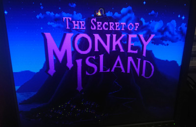

Reply 38 of 68, by Deunan
kaputnik wrote on 2023-01-16, 11:22:
Monkey Island intro, as I mentioned earlier. And 320x200 256-color mode in general, it's way easier to spot with pixel/line doubling and also you test your monitor for proper upscaling. 640x480 and higher modes usually work well, it's the lower resolutions that are problematic. EGA's 640x350 is fortunately rarely ever used. Although that seems to be a good LCD monitor - the 800x600 mode looks nice. What's the brand/type and what native resolution it has?
Reply 39 of 68, by kaputnik
Deunan wrote on 2023-01-16, 20:37:
If you mean the title screen in the original version, it looks good. No jailbars as far as I can see 😀
The monitor is a Lenovo ThinkVision LT1913p, native resolution is 1280x1024. It was basically the cheapest non-widescreen 19" IPS monitor with reasonable response times etc I could find at the time.
