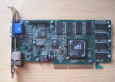

Hello,
Below is the picture of the actual card. It seems like having mounting holes:
376.84 KiB
1887 views
Intel 845GEBV2, Pentium 4 2.4 Ghz, Geforce FX5600 256MB, 512MB RAM, 160GB HDD, Sound Blaster Live! SB0100 - Win 98/XP
Reply 3 of 62, by Doornkaat
The mounting holes on those cards have a spacing no other cards used. You have to mod some heatsinks to match the spacing but it's usually no problem.
The crystal left of the main chip will collide with larger heatsinks. The main chip is also close to the AGP slot meaning larger coolers will collide with the slot and need to be filed down a bit.
The Titan TTC-CUV1AB(DIY) is a nice solution because it fits without modifications if you angle the clips a bit but it's somewhat noisy @12V. The larger heatsinks produced by Titan using the same retention clips fit the holes as well but need to be modified so they don't collide with the crystal or the AGP slot.

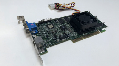

Reply 10 of 62, by bloodem
I've successfully restored some Voodoo 3 3000 cards using a 60 x 45 x 18mm heatsink from this ebay seller and a 30mm x 5m double sided thermal adhesive tape from this seller (no affiliation with either of them).
The heatsink is very similar to the original one and the adhesive tape has a very good thermal transfer. Overall, the cooler behaves better than the original heatsink + thermal glue. With a bit of airflow, the temperature measured on the card's back (right behind the GPU) after a 1h stress test did not exceed 55 degrees C, which is very good.
This is how the card looks like:
    486.02 KiB
    1775 views

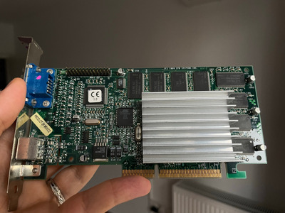

This is what I did.
Reply 14 of 62, by The Serpent Rider

Reply 16 of 62, by appiah4
stealthjoe wrote on 2023-01-28, 16:40:
appiah4 wrote on 2023-01-28, 15:26:
This is what I did.
Looks good. How did you manage to attach the heatsink to the board?
3M thermal double sided tape.

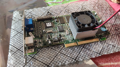

Recently attached a fan to the custom heatsink (which is attached to the main IC with a double sided thermal tape). Kept the fan as an intake (blowing into the heatsink).
254.61 KiB
1485 views
After switching on the board, a few minutes later noted that the area at the backside of the main IC was quite hot (not sure of the temp but could be around 60-65 deg C) and the heatsink was cold. Trying to understand if this fan placement is correct or whether it should be placed as an exhaust (blowing away from the heatsink). Was searching for many answers, but there seems to be a lot of debate around this. From a Voodoo 3 perspective, could someone please share their experience on using an active cooling? Thanks!

Reply 19 of 62, by stealthjoe
Had initially wanted to use a thermal paste, but alas was having a tough time finding a heatsink fan combo compatible with the board holes. Also didn't want to go with a thermal adhesive for obvious reasons. So thought of going with a heatsink (40x40x20mm) with a pre-applied thermal tape. TBH, the tape was indeed working. Was able to feel bulk of the heat getting transferred to the heatsink. The experience was quite similar to the original heatsink. This was prior to attaching the fan.
