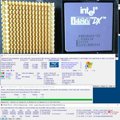

From SIV 5.70 Beta-03 I have been trying to better detect if a CPU is an AMD Am486 or an Intel i486. Below you can see this works with my two 486 CPUs, but wonder how SIV will do with others. My Intel DX2 CPU has CPUID which makes it easy to deal with and also means it's possible to deduce a CPU is AMD in some situations as it will not have CPUID. It's only AMD vs. Intel that is tricky and SIV has been able to detect Cyrix based CPUs for a long time.
If you have an AMD Am486 or an Intel i486 please will you post the SIV 5.70 Beta-04 initial and Menu->Hardware->CPUID->CPU-0 screens so I can check and if needed adjust the detection code. If you know the Sspec code please also specify this. What I need to know is what Windows reports as the Revision for a selection of AMD + Intel 486 CPUs that don't have CPUID. Below you should see my AMD Am486 DX2 reports FFD0. I expect Winodws 9x will report different values to NT 4.00 for the same CPU.

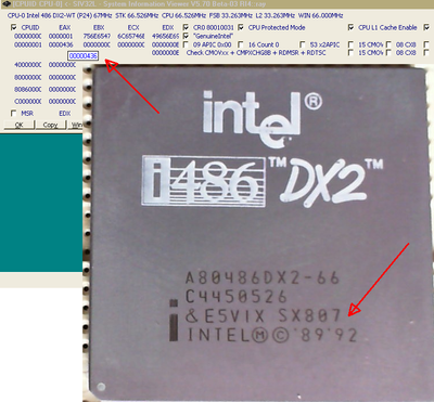

I wonder why my SX807 has CPUID 0436 which is different to the 0435 specified in https://www.cpu-world.com/sspec/SX/SX807.html

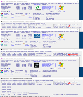

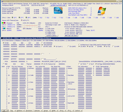

I am also interested in reports from Alpha and Itanium systems.
file.php?id=161501

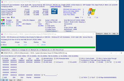

I noticed my local computer recycler had an Intel i486SX-33 so I popped round on my bike and got it. I was quite surprised when it supported CPUID, do all Intel i486SX?
file.php?id=161563
The floating performance is much as I expected, the Menu->File->Save Local took 16 minutes as a result !

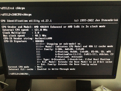

Reply 8 of 12, by drosse1meyer
See attached
CPU: A80486DX4-120SV8B
https://www.cpu-world.com/CPUs/80486/AMD-A804 … X4-120SV8B.html

drosse1meyer wrote on 2023-04-04, 17:06:
Thank you, the AuthenticAMD confirms it has CPUID support so it's easy for SIV and all other programs to correctly report it.

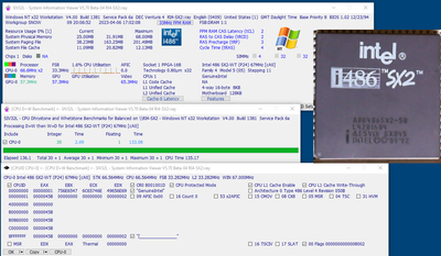

My i486 SX2-50 arrived today, it's a SX845 and supports CPUID, I think all SX2 support CPUID, do they?
It seems to happily run @ 66 MHz and the SIV [Save Local] took a mere 10 minutes rather then the 16 minutes my SX1 took.
file.php?id=161732
