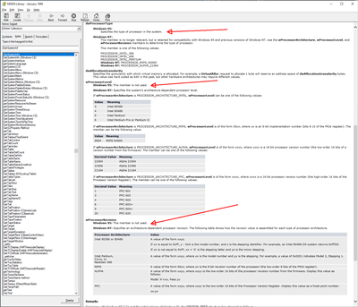

I just checked and it looks like Windows 9X does not report Level and Revision when we really need it 🙁
Level is no big deal as for 386 + 486 it's the same as Type.
Windows 95 always returns Revision zero, 98 + Me return the same as CPUID, but it looks like if there is no CPUID they also return zero 🙁
file.php?id=161471

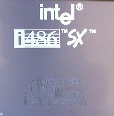

Reply 22 of 56, by red-ray
I felt I needed an Intel 486 that did not have CPUID support and noticed my local computer recycler had an Intel i486SX-33 so I popped round on my bike and got it. It's CPUID 0423 and had CPUID support, I wonder do all Intel i486SX have CPUID support?

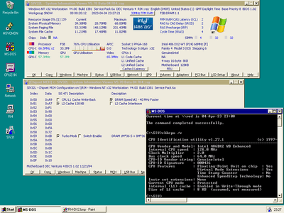

Reply 23 of 56, by red-ray
mkarcher wrote on 2023-04-03, 16:22:
Writing to CR0 to enable WB is a Cyrix thing, accompanied by locking the NWT "no write-through" bit to keep the cache in WB. For Intel/AMD processors, the processor enables the WB protocol if the WB/WT pin is pulled high on RESET. If the WB protocol is enabled, the processor samples the WB/WT pin during every cache-line fill, and if the pin is high at that point in time, write-back is enabled for that line. Typically, that pin is jumpered to either "high" or "low" all the time, so in WB mode, all cacheable memory is write-back capable.

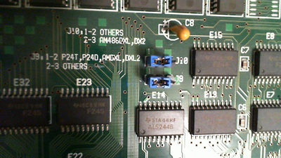

Yesterday I noticed there was a P24D jumper, so I selected it, installed my DX2 CPU and checked what happened. Below you can see WB does not seem to be enabled, do you have any thoughts as to why? The Venturis 4 manual is hazy about WB on the V1 board I have and I wonder if it only works for Intel CPUs on the V2 board.
file.php?id=161576
file.php?id=161577

Reply 24 of 56, by jakethompson1
red-ray wrote on 2023-04-04, 23:33:
Take a look at this chart: https://x86.fr/wp-content/uploads/2021/06/P5O … out-768x758.png
and see whether your board has connectivity between C14 and pin T1. Note that these are Pentium OverDrive pin numbers, not 486 pin numbers. If not, you have one of the boards mkarcher was alluding to (I have one of them also). You can also check whether either side of the jumper has connectivity with either of those two pins.

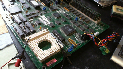

Reply 25 of 56, by red-ray
jakethompson1 wrote on 2023-04-05, 03:03:
Thank you, C14 is connected to T1, but I can't find connectivity to any jumper pin, which pin should it be connected to please?
The board I have the the DEC Ventutis 4 V1, Service Maintenance Manual attached.

Reply 26 of 56, by mkarcher
red-ray wrote on 2023-04-05, 07:41:
This likely means that enabling WB mode is not implemented on the V1 board. Unless there is a short circuit between C14/T1 and ground, try connecting that pin to Vcc (to be safe, you can use a 4.7K resistor or something like that). If you are lucky, all other provisions for the WB mode are already present. If you are unlucky, your system will crash as soon as you try to access the floppy, or it will read/write garbage data. In the latter case, the board is likely not designed for L1WB on P24D-type processors (Intel "&EW") at all.

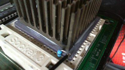

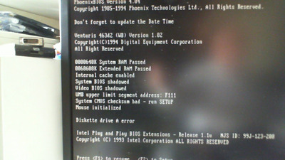

Reply 27 of 56, by red-ray
mkarcher wrote on 2023-04-05, 08:47:
Thank you, I gave it a try, with 4K7 to VCC I saw about 4.6 Volts on T1, the system posted, said (WB) and corrupted the CMOS. I also noted the 463 meaning a speed of 63 rather than the usual 66 MHz.
Is what I did what you had in mind? What do you think would happen if with the 4K7 installed I used a 486SX-33 or 486DX-33?
After I removed the 4K7 and restored the CMOS all is back to as it was before.
Reply 28 of 56, by mkarcher
red-ray wrote on 2023-04-05, 11:31:
Yes, it is. It seems to show that the board is physically not compatible with the Intel &EW WB protocol, even though the chipset and the BIOS would support it if the required traces and jumpers were present. You basically have to add some bodge wires between the chipset and the processor socket to make the WB protocol work. Unless you specifically need WB in that board in that machine, or you enjoy physically tinkering in with your hardware, getting a different board for 486 WB support is likely the smarter approach.

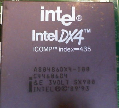

Reply 35 of 56, by red-ray
jakethompson1 wrote on 2023-04-05, 23:09:
Thank you, very handy. It says the Intel DX4 supports x2.5, so I just tried it and it does not work, my CPU ended up @ 66 MHz rather than 83 MHz, do you know if x2.5 should work please ?
It's connected using the interposer shown in Re: Digital Venturis PSU type, Video DRAM chips and CPU Upgrade Options

Reply 36 of 56, by jakethompson1
red-ray wrote on 2023-04-05, 23:32:
The Vogons Wiki (and I have read it elsewhere) says that was supposed to be for a DX3 (thus the DX4 being x3) but it was never released.
