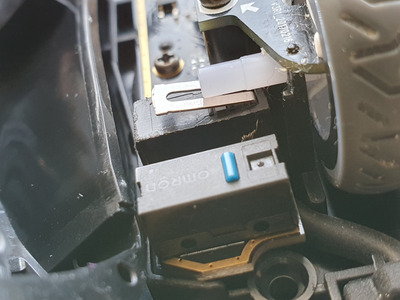

ok, so i have added a levered switch for the scroll button in my mouse 😀
it's the lightest pressed button now 😀
at first i tried that button rotated 180 degrees (required unnecessary drilling one hole... and unnecessary shortening (cut) the lever too...)
but it was always clicking when scrolling up that way. Always 😀
scrolling down was ok if you were very gentle.
so i tried rotating it 180 degrees and it works perfectly now 😀
i think the click is a bit shallower now but not sure though
third pin had to be cut off and polished as not used in this mouse (steelseries rival 310)
pins had to be also polished on sides cause they were too fat in the button i used (i polished both sides but i guess i could just polish one side to even move the switch a bit to the side to soften it even more.
oh, the button is unnecessarily tied with a wire cause i broke one latch when tried to soften the button inside so i opened it and couldn't figure out how to close it 😉 untill now (almost 3 years) 😉 first i tried to close it with inside rotated 180 degrees which was not possible that way hence broken latch 😀 works perfectly tied up though 😉 i guess i should have bought a new one.. we will see how long it gonna work 😉
same method won't work in razer deathadder 1 as it has too low celing i guess (if it still works after cutting the case pillar 🤣) (cause the button is on the second floor)
if you have any questions feel free to ask 😀
also i am not sure if my bending plates inside the button added some extra softness to the button

got two more switches of the same type and they are indeed very hard to press so i indeed modified the inside before to make it way softer. so i guess they might work 180 degrees rotated with a scroll if not modified but i am not gonna check that now.
anyway i got used to the shallower scroll and planning to change other buttons too to make them softer.
the harder part here is i cannot rotate them 180 degrees as they use all 3 pins so i have to soften them by modifying the inside again... or buy a softer ones somewhere. and also have to buy ones with out hole in the lever cause this hole won't allow using lever. the shop only had this switch. lots of shops disappeared recently during pandemy... checking hardness through internet is not an option for now...
Reply 69 of 77, by robertmo
ok, so after i got used to slightly shallower clicking with new middle button, it started double clicking, triple clicking, not clicking and now i got auto fire 😀 never seen hardware autofire before btw 😉
i expected it to work longer than a month 😀

on the other hand when i look that the time that passed is almost exactly the same i think it may actually be wear out "hinges" of a leaver. Which basically means at least this switch won't work.
