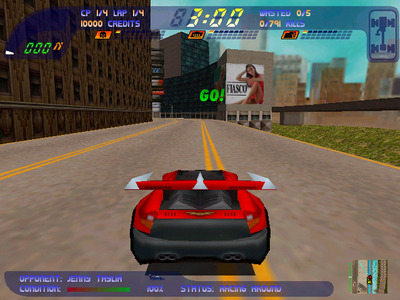

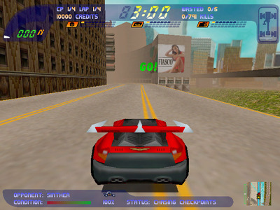

Reply 3 of 153, by Joseph_Joestar
Games tested:
  • Carmageddon II - retail CD release + latest official patch version 1.2
Graphics cards tested:
  • 3DFX Voodoo3 2000, using 3DFX reference drivers version 1.07.00 (Glide renderer)
  • Nvidia GeForce FX 5900XT using Nvidia reference drivers version 45.23 (Direct3D renderer)
104.6 KiB
4097 views
122.8 KiB
4097 views
When using the Direct3D renderer, fog is missing and the far away buildings on the right side of the screen have lower detail. Game detail settings were all at maximum during both tests.

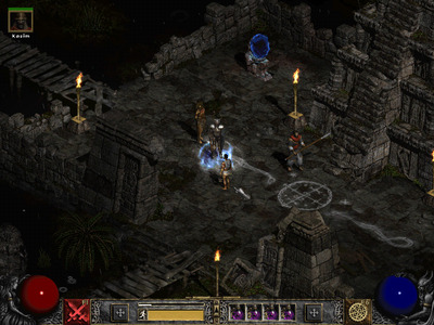

Reply 4 of 153, by Joseph_Joestar
Games tested:
  • Diablo II - retail CD release + LoD expansion + official patch version 1.13d (the latest one which works under Windows 98SE)
190 KiB
4084 views
176.33 KiB
4084 views
Testing was based on this report by user ratfink. As indicated by the report, the dagger inside the blue energy sphere is missing in Direct3D mode. Additionaly, the white drawings on the floor appear to be slightly less detailed in Direct3D mode.

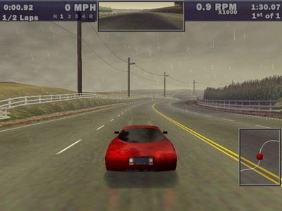

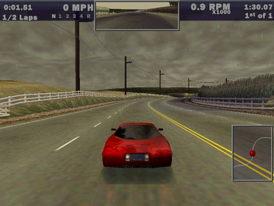

Reply 5 of 153, by Joseph_Joestar
Games tested:
  • Need for Speed III: Hot Pursuit - retail CD release + official Voodoo Banshee and Voodoo 3 patches applied as per these instructions by user Gamecollector.
133.46 KiB
4080 views
135.09 KiB
4080 views
Fog effects are missing in Direct3D mode while being present in Glide mode, specifically in Glide 2.x.

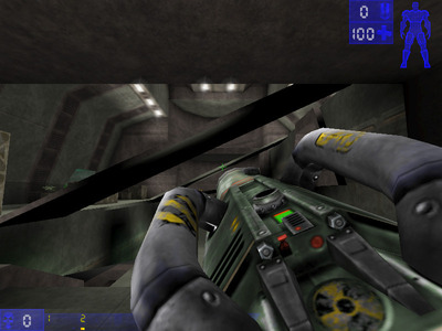

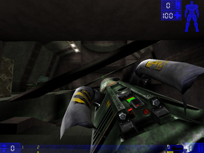

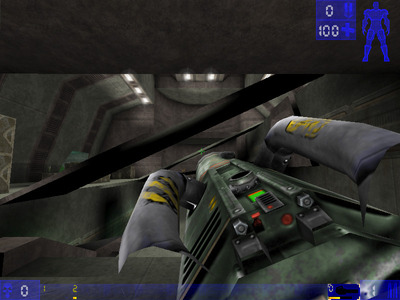

Reply 9 of 153, by Joseph_Joestar
Games tested:
  • Unreal - retail CD release + latest official patch 226f
  • Nvidia TNT2 M64 using Nvidia reference drivers version 3.68 (OpenGL renderer)
file.php?id=169255&mode=view
At the very start of the game, when you're exiting the first room through the ventilation shaft with the green fog, there's a junction where the pipes on the ceiling are leaking gas in two spots. Under Glide, the leaky gas is animated in both spots. In contrast, under the stock Direct3D renderer, only one leaky spot is animated, while the other one is visibly frozen in place (completely static).
120.64 KiB
3878 views
52.64 KiB
3878 views
The stock OpenGL renderer doesn't support detail textures, which makes it less desirable than Glide. I should note that Unreal's stock OpenGL renderer crashed with my GeForce FX 5900XT using 45.23 drivers, but it worked fine with my TNT2 M64 using 3.68 drivers.

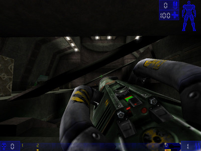

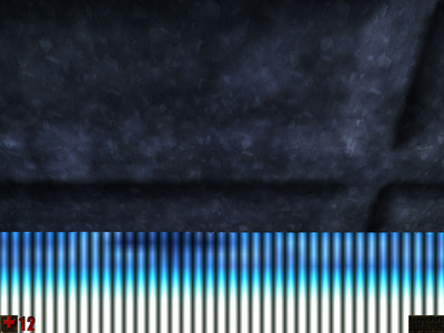

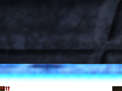

Reply 10 of 153, by Joseph_Joestar
Games tested:
  • Unreal Tournament GOTY - retail CD release + latest official patch v436
  • Nvidia GeForce FX 5900XT using Nvidia reference drivers version 45.23 (OpenGL renderer)
104.34 KiB
3995 views
84.9 KiB
3995 views
102.87 KiB
3891 views
The stock OpenGL renderer doesn't display the Redeemer weapon correctly. Additionally, it has no support for detail textures, which is visible by the lower quality textures on the nearby walls and floors. The stock Direct3D renderer also doesn't display the Redeemer weapon correctly, but it does at least support detail textures.

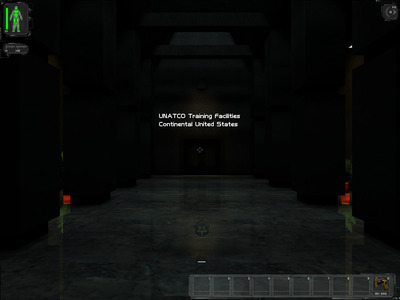

Reply 12 of 153, by Joseph_Joestar
Games tested:
  • Deus Ex GOTY - retail CD release (1.112fm)
128.46 KiB
3803 views
72.94 KiB
3803 views
Reflective surfaces appear to have slightly more detail in Glide mode. Not sure how well this will come over due to the JPG format and the forum's own image compression, but you should notice that the star symbol reflected on the floor is slightly sharper in the Glide screenshot. Same goes for the plant leaves. You can also make out individual brick tiles around the reflected star symbol in Glide mode, while those are simply a blur under the stock Direct3D renderer. I have the source BMP files and the difference is more pronounced on those.
There could be other differences between the two renderers, but this is what I was able to spot immediately after starting the tutorial level.

Reply 14 of 153, by auron
i remembered that i had the redeemer effect in UT look correct on a TNT2 once in D3D, with either 1999 or 2000 drivers, so i just tested it on a voodoo3 (1.07.00 drivers w/ v436 game) and it works there too. so this is really a driver issue more than anything, may be worth looking into when nvidia broke this and how ati fares.
it should also be mentioned that fog can be manually enabled as well in the D3D renderer, however the washed out image always looked bad to me and even fiddling with the brightness setting can't seem to quite get a result that matches glide.
Reply 15 of 153, by Joseph_Joestar
auron wrote on 2023-08-20, 13:07:
Can confirm that the Redeemer weapon displays correctly under Direct3D on my TNT2 M64 using driver version 3.68.
91.58 KiB
3650 views
I did notice that the lights on the ceiling got a bit fuzzier with that card/driver and the game's UI was occasionally glitching out (see bottom right corner of the screenshot).
Yeah, the washed out look seems to be inherent to the stock Direct3D renderer. The colors in Glide mode look more vibrant.

NFS3 I noticed fog and lighting missing that had been missing.
I think NFS4 also benefits from fog, say on Celtic Runes track? I'd check but my reto fleet is currently immigrating to Australia
