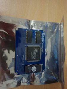

Well the updated VGA module arrived, it's a Cirrus GD542x which is a solid choice, some are Trident 9000i I think.
From looking up the chip I think it even has 512k of memory which means it has decent Windows 3.0 prospects - I wonder if the screen can do 800x600.

hi, i got a ver 2 book 8088 coming and cant wait. All the vga ive seen have been cirrus chips. i also have the first version and am waiting for some parts to "fix" 🤣 . got a couple lcd screens to try as mine has a green pixel stuck and also viewing angles crap. and new speakers as mine seems to crackle/vibrate.
Cool, they're classics. ^^
Some have mode utilities and can be set into CGA, EGA and Hercules emulation modes.
Higher text-mode resolutions, too.
