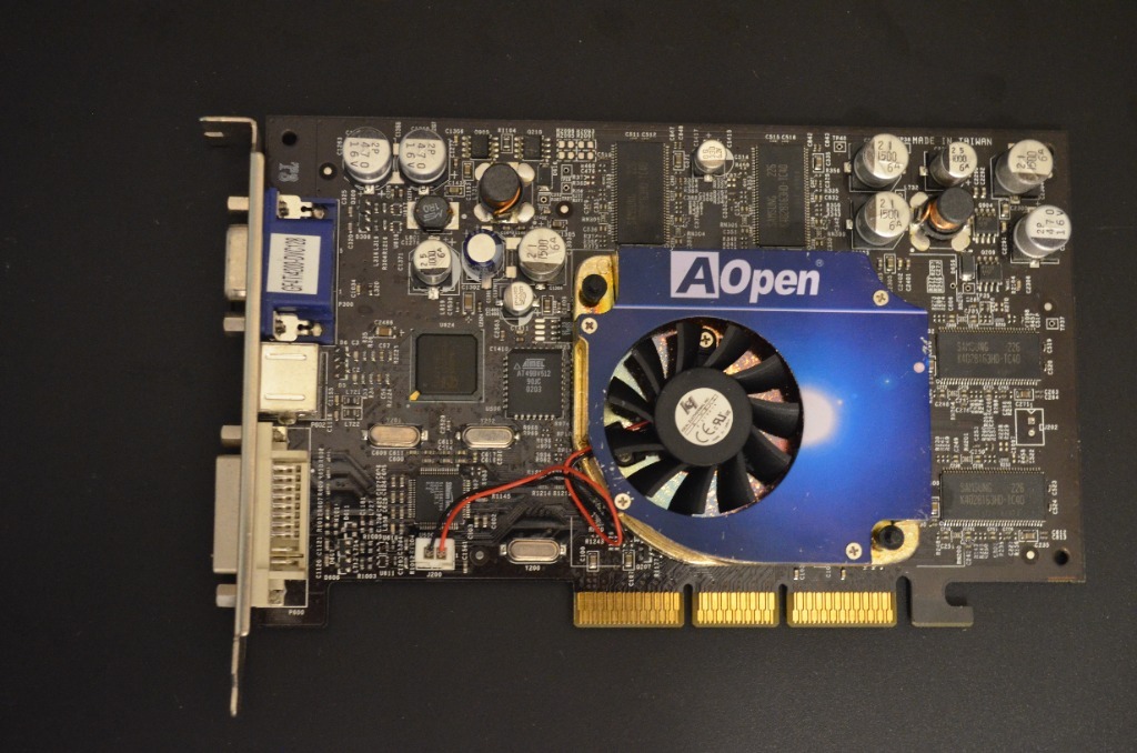

dm- wrote on 2023-09-19, 04:19:
i have a AOPEN Ti4200 like this one
will grab the bios a bit later
This looks exactly like my card (minus the DVI port). Would like to do a diff with my extracted bios to see if it is different.

dm- wrote on 2023-09-21, 04:09:
Here it is. AOpen GF Ti4200 4.25.00.30
Thanks. But this is a bios for the NV25 (non AGP 8x) so I can't use it. 😀
