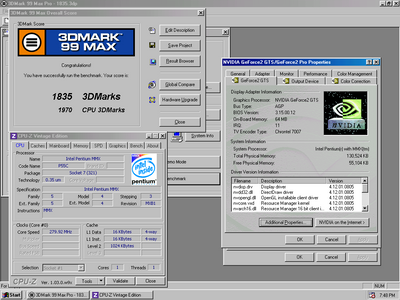

Reply 85 of 103, by danieljm
Soooo... I think I'm winning... 😀 edit: for 3DMark 99, obviously. I got excited and forgot to do 2000.
127.89 KiB
2126 views
Just picked up a Geforce 2 Pro, and I had it on my mind that I wanted to use it to try for the record. This was actually my first attempt and there's only an overclock on the CPU. I might go back and fiddle with GPU clocks, BIOS settings, and driver versions to see if I can push it further. edit: now I have to work on beating the actual record that's important (3DMark 2000). 😁 First test was only 1629, so I'm a ways off the lead.
Mobo: FIC VA-503+ with 1MB cache
CPU: 233 MMX @ 112MHz x 2.5 = 280MHz
GPU: Asus V7700 Pro 64MB, driver 8.05, default clocks

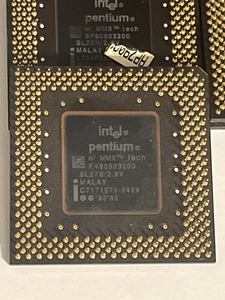

Reply 86 of 103, by Sphere478
200mmx pretending to be a 233mmx
    1.16 MiB
    1996 views
Sphere's PCB projects.

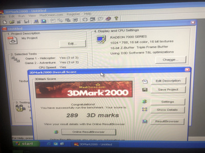

Reply 87 of 103, by Mamba
And here is my Supercrappy dual P233mmx
-Ga-586dx
-dual 233mmx
-320mb Simm
-Radeon 7000 (rv100)
-WinXP pro sp2
-cat 4.3 taken from Vogons library as 6.2 won’t work with 3D apps in my system.
Very disappointing…
    1.42 MiB
    1898 views
Reply 88 of 103, by Sphere478
That’s unusual I would have expected one or two hundred more points.
Do you have a usb card by chance in this?
Reply 89 of 103, by BitWrangler
Take some RAM out, try again at 256MB
Reply 90 of 103, by Sphere478
BitWrangler wrote on 2023-10-08, 02:03:
Maybe they don’t have 512mb cachable enabled?
I recommended mamba try win 2k or 9x also off site.
Reply 91 of 103, by BitWrangler
If it's fully tagged, but there's some slowdowns with every extra address line used, minor usually, but sometimes they're weird.
Reply 92 of 103, by Mamba
Sphere478 wrote on 2023-10-08, 03:41:
2K was challenging to install and even then, somehow the board was unstable.
XP is perfectly stable now.
No usb card installed (I still need to find one that do, probably I need to find a Opti 1.1).
There is one pci sata card (but the OS is loading from the onboard IDE).

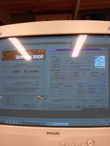

My first attemt at 225mhz 112x2. I used the same system as I did in this thread. I just the swapped cpu
AMD K6 3DMARK, aiming for stars.
1899 Points!
Asus P5A rev 1.04
Win98SE
128mb PC133 CL2
Geforce2 Ti

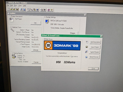

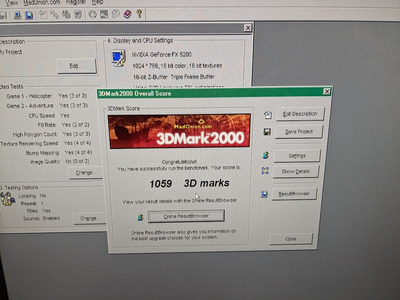

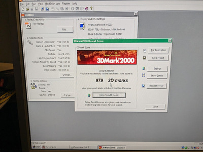

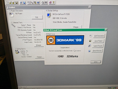

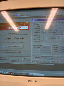

Been playing around with my windows 95 P233MMx today, its an Asus SP97-v with the video disabled, 64mb of edo, windows 95 osr 2.5 and a pci nvidia quadro 280, which the drivers see as a fx5200.
Motherboard only has jumper settings for upto 75mhz, I have got a modded bios installed from 2002 that is meant to give 83mhz but there doesnt seem to be any mention on how, also running at stock speeds I can run much tighter timings on memory then at 75mhz as it wont boot with the timings at 66mhz.
3.5x75 for 262mhz first two and stock 233mhz for the 2nd two
