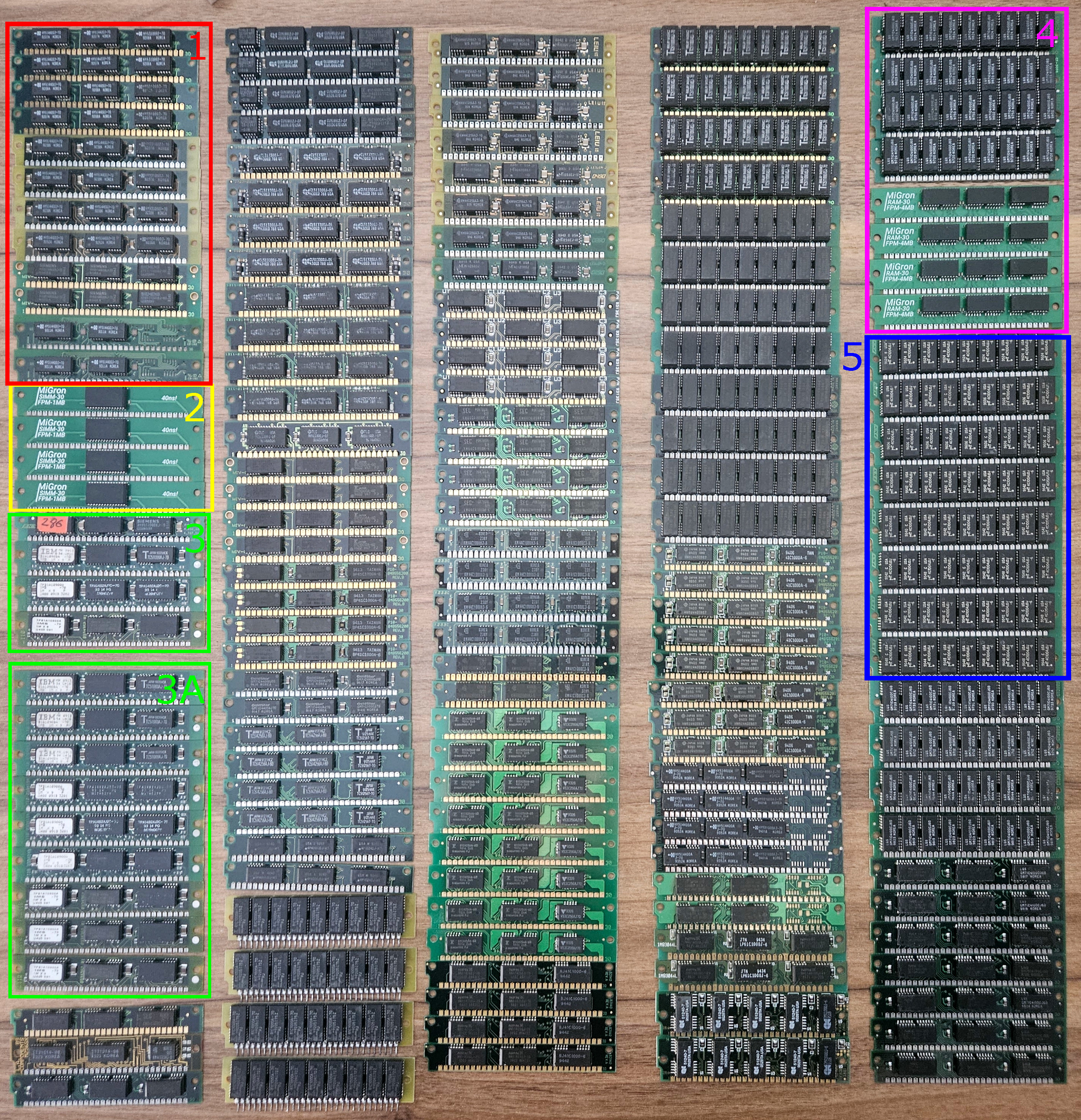

It was established early in the thread which are the best 72-pin FPM/EDO RAM modules for peak 486 overclocking. Results were validated by other forum members to hold true.
At the same time, despite the plenty of noise around 286 and 386 hardware, the RAM related details were mostly left untouched.
Was not able to find much in the pile of posts while looking for some specific information.
Running a wider search in the forum and online didn't go well either. So, decided to add some notes for the record.
This is roughly two-thirds of the 30-pin memory modules here. The other third is scattered across several motherboards. Didn't bother collecting it for the photo.
The picture is basically clarifying that a lot of RAM sticks were tested on a lot of different 286/386 motherboards over a lot of years before any conclusions were drawn.
The first 4 columns on the left are all 1Mb modules. The column on the right is 4Mb ones.
While 386 and later hardware is somewhat tolerant to RAM chips quality, the fast 0-wait state 286 systems are brutal towards them, especially when overclocking is in order, so will start with that.

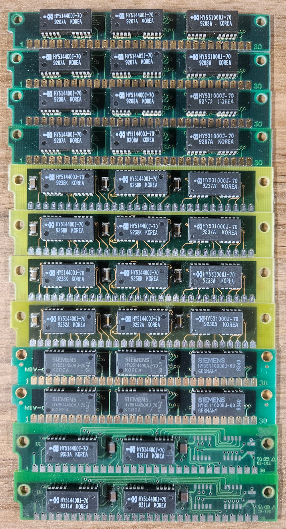

The best chips and modules are the ones in zone 1.
All of them are 27.5MHz 0-WS capable in 4x1Mb configuration.
Roughly half of them are 30MHz 0-WS capable, but in 2x1Mb configuration only.
Hynix HY514400J-70 + parity chips Hynix HYB511000BJ-60 (relabeled by Siemens) or Mosel-Vitelic VT531000 J-60.
There are no modules with VT531000 J-60 parity chips in the photos because i use them in the 286 hotrod PC. Didn't feel like pulling them out.
The last two sticks are with two chips only - they are problematic for 286 machines because of parity. A transplant will be needed to enable them.

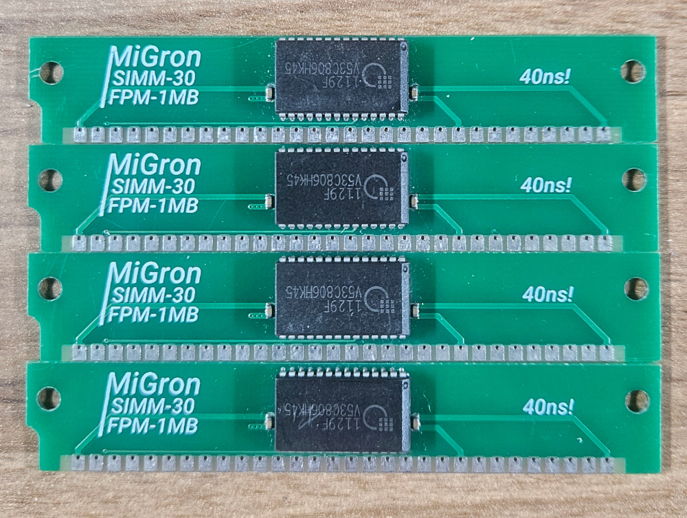

Equally good are these 1Mb modules from MiGron (a forum user), based on 45ns rated Mosel-Vitelic V533C806HK45 chips.
Their packaging is a problem for all 286 chipsets i touched so far. It takes at least 286/386 hybrid silicon like Headland HT-16 or HT-18 to see them.
Motherboards based on them are impressive and can tick fine well beyond the 30MHz, but have internal wait states which reduce strain on the memory but lower the overall performance, so i am not sure if these chips are in fact better than the ones in group 1. Still, they are great for the right type of 286 boards.

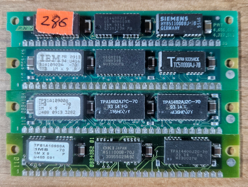

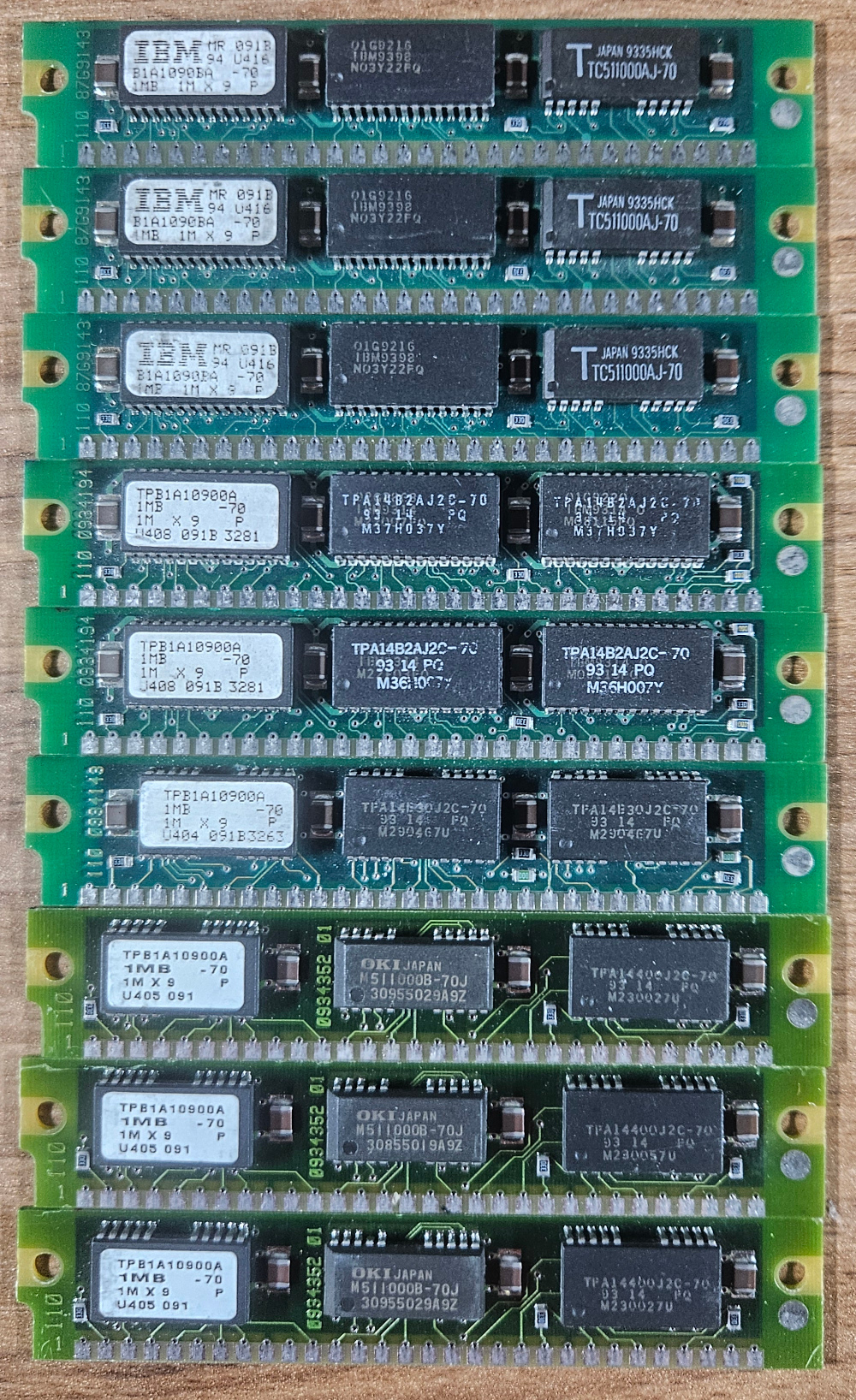

The next best chips are in groups 3 and 3A, where group 3 is a curated subset of 3A.
IBM branded modules. Some of them work really well at up to 25MHz 0-WS, including in 4x1Mb configurations.
A hodge-podge of different chip brands/models.
OKI and Siemens using Hynix HYB511000.
Also, clumsy relabeling - multiple serial numbers and other stuff printed on top of each other.
Group 3A.
These are good for 16-20MHz 0-WS in 4x1Mb configurations.

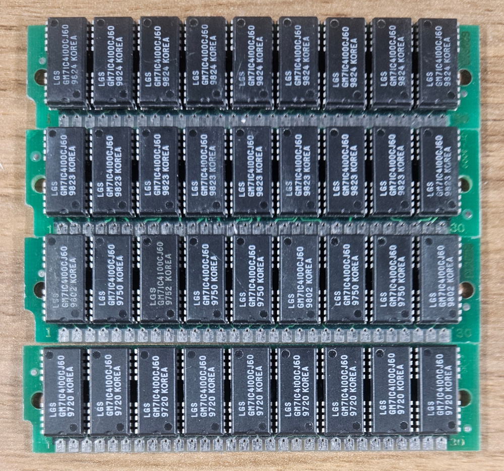

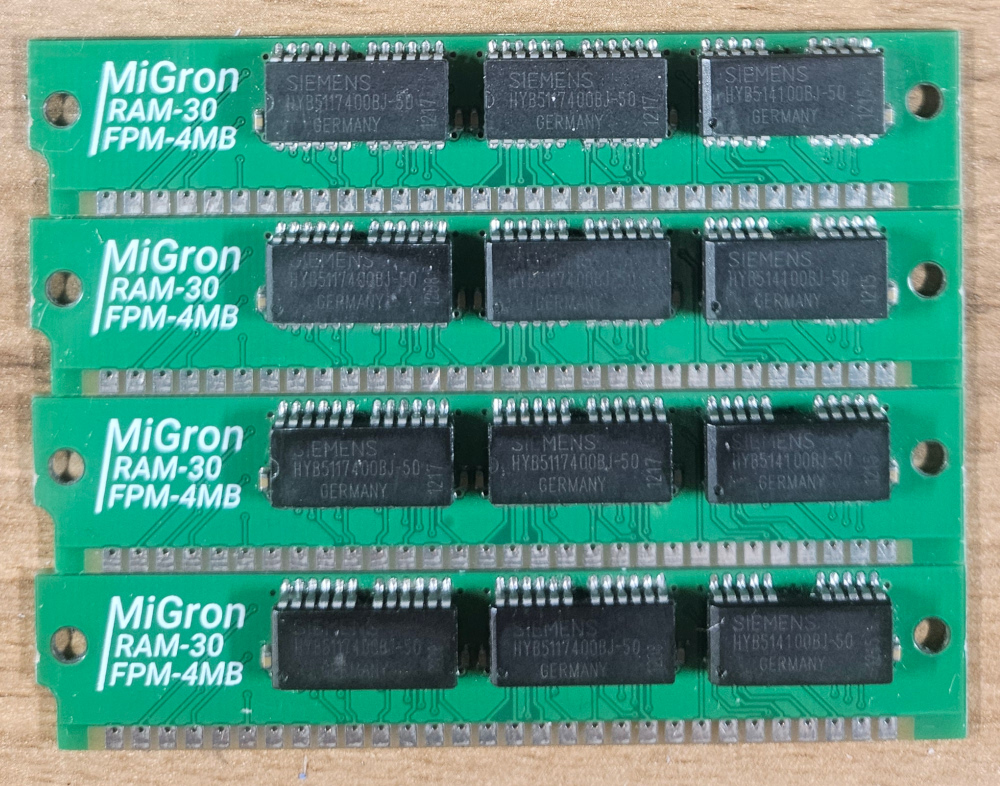

The best type of modules are in group 4.
Both of them are performing equally well in 2-3 hotrod 386 motherboards ticking at 50 and 55 MHz base frequency and 2-WS.
The first 4 sticks are based on LGS GM71C4100CJ60.
The second 4 are from MiGron and using Siemens relabeled Hynix HYB6117400BJ-50 chips.
The Micron based modules in group 5 are also very good, but roughly half of them are unreliable in fast 386 motherboards at 50MHz or more.

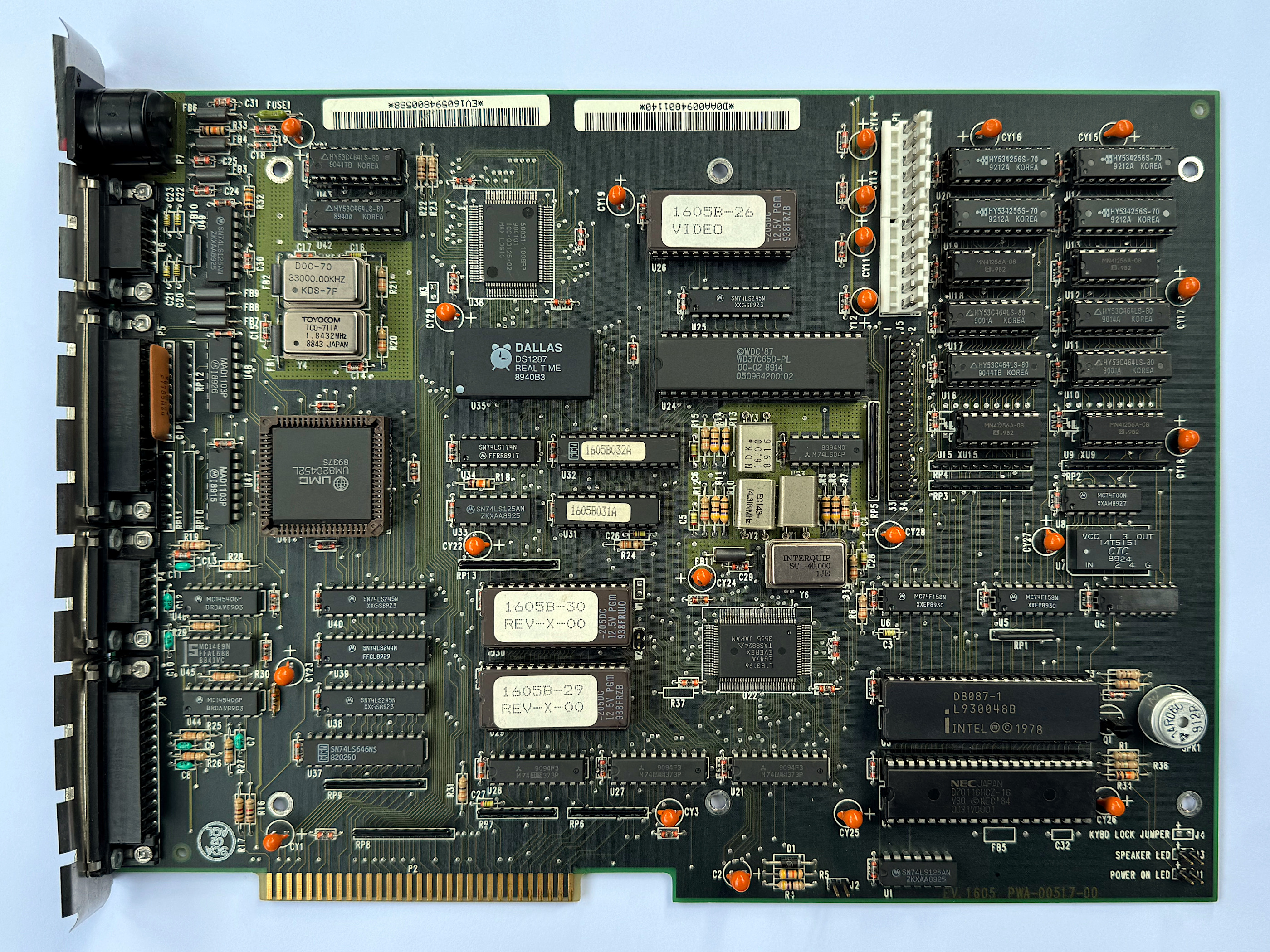

Everex STEP NS EV-1605B - an impressive 8086 / Turbo XT motherboard.
Assembly is in pristine condition - crisp.
Build quality is impressive. That statement is especially true in the context of XT class hardware.
It is either a very late product - won’t be surprised if it is from year 1993-ish, or if it was released before then - it was some high-end piece of equipment, and hats down to Everex designers/managers for that.
I am totally guessing here since cannot find any information about release date, product line, etc.
The board is not a standard AT form factor. This almost made me skip on it since i keep healthy distance from custom/proprietary contraptions.
The standard AT power connector and included ISA slots connector tipped the weights in favor of buying it. Glad i did.
The board has plenty of gear integrated - FDD controller, COM/LPT controller, CGA/EGA graphics adapter.
Not sure which ICs implement the on-board video card. Cannot find any information about the two main chips. Must be the one in the upper left corner but who knows.
Included were 10MHz rated Siemens 8086 CPU and 640Kb of 120ns system/video RAM.
The Siemens CPU was substituted by 16MHz rated NEC V30HL.
Populated the empty FPU socket with my best 10MHz rated Intel 8087 chip. These get hot, so heatsink+fan are mandatory or overclocking is not happening.
Another important feature of the board is the small number of RAM chips.
Fewer RAM chips means better chance of higher overclock since overclocking of 808x hardware is usually limited by quality of RAM (and FPU). More chips makes it harder to bin and filter out flakes.
Replaced the 640Kb of 120ns chips with trusted 70ns rated Hynix and 80ns Micron ones.
The socketed system/video RAM is a time saver otherwise i would have to add the sockets. This is necessary to rotate chips around until find a set that allows stable overclock.
There are plenty of crystal oscillators present.
The two in the upper left corner are related to the on-board graphics adapter.
Then there is four in the middle.
The upper one is for the floppy (i think).
The 14.3181 does not need explaining.
The full-can is for the system clock.
The fourth one - not sure what its purpose is.
There is a BIOS menu that allows changing some options like floppy drive(s), display type, etc.

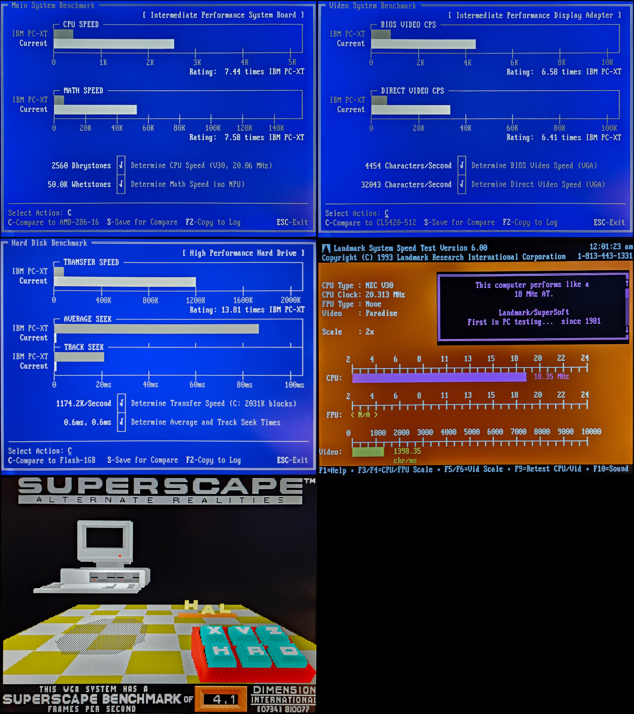

--- performance
This motherboard is slightly slower than Tandy 1000SL on a clock-to-clock basis, but overclocks like crazy. Will use the word "impressive" again.
Didn't think 808x hardware is 20MHz capable, but was proven wrong, with one small caveat - no FPU.
The best 8087 FPUs are up to 10MHz rated. Some rare chips can go up to ~17MHz, but no further. 20MHz is just too much for them.
For the testing i used Lo-tech XT-CF-lite rev.2 adapter and Western Digital WD90C00-JK 512Kb which is the fastest video card for XT machines.
Here is how some benchmarks look at 20MHz:
The board was tested at 10MHz (for clock-to-clock comparison with the rest), 16.5MHz with full gear (including FPU), and peak overclock of 20MHz (without FPU).
It is completely stable in all 3 configurations.
And the best part - it just does it !
... which i found ... impressive.
benchmark results in the following post

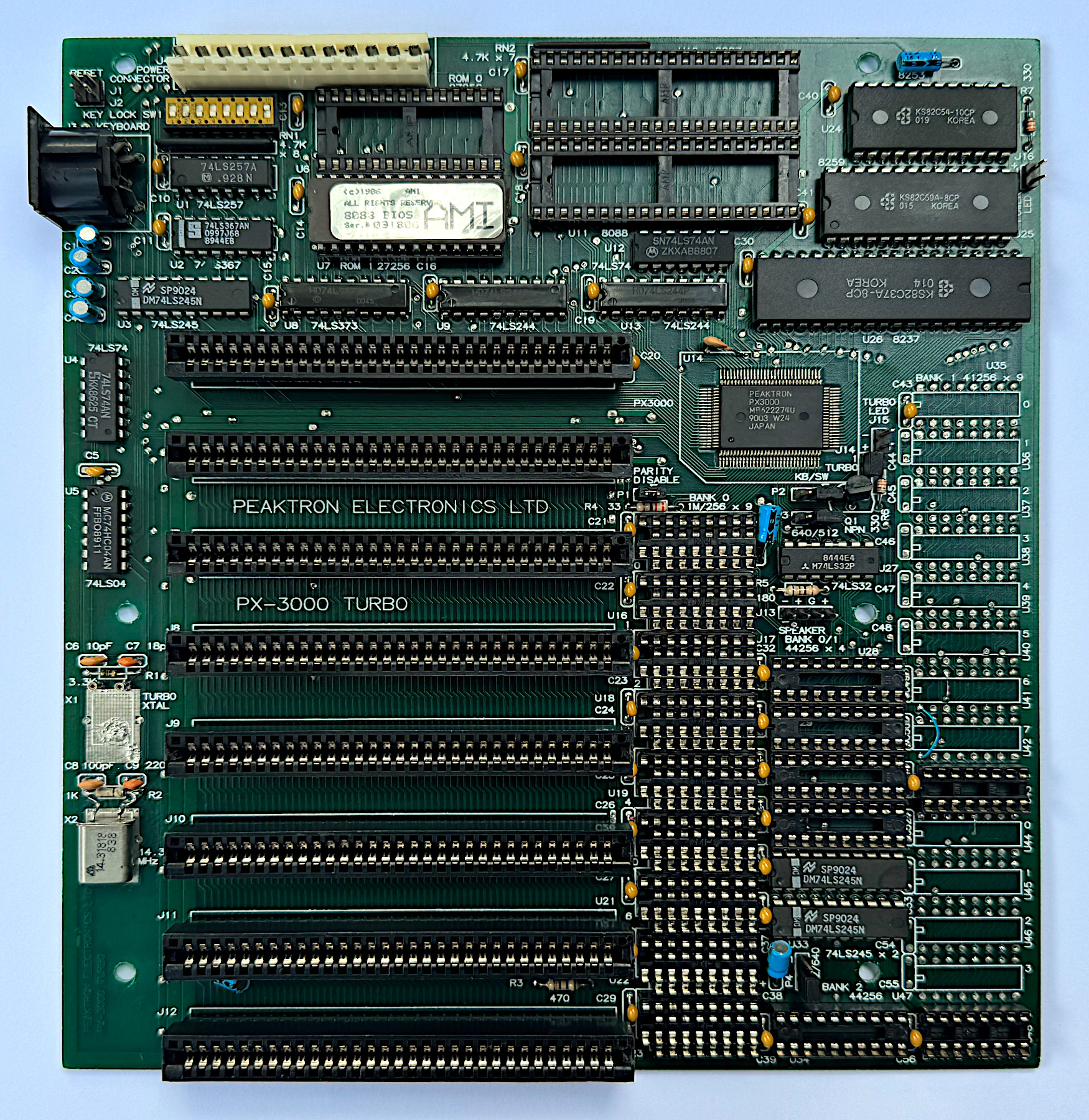

Paktron Electronics Ltd. PX-3000 Turbo - an 8088 Turbo XT motherboard based on the PX3000 (?) chipset.
An interesting looking package.
Highly integrated, very compact, still in great condition.
First time seeing this "chipset". Not sure if it is an unique design, or something relabeled.
All good and everything, but what actually caught my attention was the supported memory configurations.
Only 4 chips are required for 512/640 Kb - an important factor for XT overclocking activities.
In the majority of the cases RAM is the limiting factor, since these old memory chips don't handle very well higher frequencies.
The strategy is to curate a set of them that can do it. Fewer chips = faster curation process and improved reliability.
Base frequency is 4.5MHz.
Turbo mode is 9MHz.
Desoldered the 27MHz crystal oscillator and put female pins in the corresponding through-holes.
The board actually functions just fine without the TURBO-XTAL oscillator.
Either the base frequency is derived from the 14.3818Mhz one, or the main IC has integrated clock generator.
But if TURBO-XTAL oscillator is present, it is considered.
The Retro Web has documentation for jumpers and switches. Won't go through any of that here.
Tested with the next components:
16MHz rated NEC V20 CPU
10MHz rated Intel 8087 FPU,
70ns rated 512Kb RAM, Hynix
Western Digital WD90C00-JK 512Kb video card (seems to be the fastest thing for 808# machines)
Lo-tech XT-CF-lite rev.2 XT-IDE controller with Transcend 2Gb CF card
DOS 4.01
Had big hopes about this assembly, but they didn't materialize.
9MHz is the maximum the system can take. That was a bummer.
The rest of the used components can take much higher frequencies, as shown in previous posts.
So, the limitations seem to be in the motherboard itself.
benchmark results
Neat looking motherboard.
I can see how it can be a great fit for someone's compact Turbo XT build.
Unfortunately does not overclock at all, which limits potential fun activities and tinkering around it.
