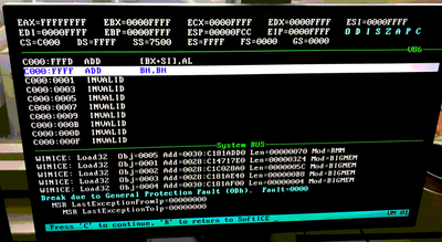

Reply 85 of 269, by BEEN_Nath_58
Falcosoft wrote on 2023-12-11, 22:19:
Yes, GTX 1xxx should have the same DOS compatibility level as GTX 9xx.
That is Function 07h - Set/Get Display Start calls fail and as an64 pointed out Function 0Ah - Return VBE Protected Mode Interface calls also fail.
But both of these problems can be cured the same way on GTX 1xxx as on GTX 9xx.
Quake gets a GPF on both my machines, I used FreeDOS to run it. Not sure how to fix that, I have both HIMEMEX and JEMM386 loaded.
On the machine that has a working "Legacy USB support" motherboard setting, I played the first level of Duke Nukem 3d but I don't recall seeing any problems on the Ivy Bridge chipset. On the GTX1000 series machine the keyboard doesn't work in games, maybe I will need a PS2 keyboard after all, but once I get it to work I should be able to test it. Is there some specific spot that I should check? Btw the game runs and starts the demo and I don't see any issue there..
One thing that I can't recall, if it is true or not, when I tested the DN3D on the Ivy Bridge machine with the menu on launching the game (not exiting to title screen), the menu demo runs that when DN drops into the water, and all the menu elements turn into pink from red-orange.
Edit: I decided to perform the test on the VMware BIOS and that one is even more crippled: Falco's test freezes even before the whole square is displayed.

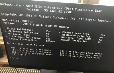

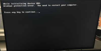

Reply 86 of 269, by trannks
Do you know about this issue with GTX 1060 3GB(MSI) but not with GTX 750 1gb(MSI)?:
gtx 1060(3gb), when booting I get error 'vdd protection error', booting with gtx 750(1gb) there is no error:
The attachment IMG_1982.png is no longer available
The attachment IMG_1983.png is no longer available
vdd may be basic video driver ?:
display=*vdd,*vflat ; from system.ini, section [386Enh])
bootlog stops at:
[000BB02E] Dynamic load success C:\WINDOWS\system\IOSUBSYS\bigmem.drv
[000BB02E] DEVICEINITSUCCESS = IOS
[000BB02E] DEVICEINIT = PAGEFILE
[000BB02E] DEVICEINITSUCCESS = PAGEFILE
[000BB02E] DEVICEINIT = PAGESWAP
[000BB02E] DEVICEINITSUCCESS = PAGESWAP
[000BB02E] DEVICEINIT = PARITY
[000BB02E] DEVICEINITSUCCESS = PARITY
[000BB02E] DEVICEINIT = REBOOT
[000BB02E] DEVICEINITSUCCESS = REBOOT
[000BB02E] DEVICEINIT = EBIOS
[000BB02E] DEVICEINITSUCCESS = EBIOS
[000BB02E] DEVICEINIT = VDD
Tested on asrock h87(haswell) and on z690(alder lake), its the same issue.
Also on gtx 1060 the blinking cursor in dos blinks many times faster than normal. This is not an issue with gtx 750.
in autoexec, I tried with nvuvafix.com /v:
VBEVSTST.EXE reports this, and switching between 00h and 80h seems accelerated, did it a few times and it froze:
GetStart is supported
GetStart call failed
GetStart is Supported <00h> (and 80h)
GetStart call failed <00h> (and 80h)
in autoexec, i tried with MSKVBEF7.COM:
VBEVSTST.EXE reports this, switching between 00h and 80h seems normal and after I did it a few times it did not freeze:
With both it does not fix the fast blinking cursor in dos and still the same VDD error when booting windows.
Can't boot win98 if the gtx 1060 is in the pcie slot.
I can dual boot win10 and win98 with GTX750 and ati x600 pcie.
VBETEST.EXE:
