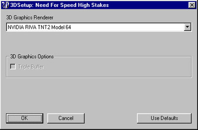

Reply 572 of 653, by Joseph_Joestar
Sombrero wrote on 2024-06-23, 09:08:
Nope, I noticed the same thing. Actually in fact NFS4 tops out at 1024x768 with that dll on my system.
I think it's an arbitrary limitation that EA imposed when using an "unknown" (to the game) Direct3D device.
That a radeon thing or an engine D3D thing? Pretty sure NFS3 could go at least 1024x768 with Voodoo3 Glide, while it now tops at 800x600 with X700 D3D.
I just tried NFS3: Hot Pursuit on my TNT2 M64, and it has the same resolution cap, since it's an unsupported card in that game. However, I then tried NFS4: High Stakes on the TNT2 and it allowed me to go all the way up to 1600x1200 because this game does recognize that card:
The attachment NFS4_Config_TNT2.jpg is no longer available
The attachment NFS4_Options_TNT2.jpg is no longer available
Pretty weird, but that's what the "geniuses" at EA decided I guess. Not a whole lot of future proofing by the programmers.
My retro builds

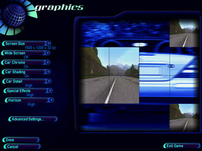

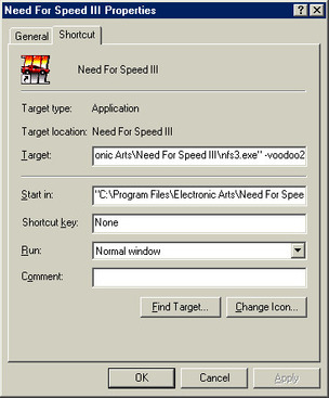

Reply 573 of 653, by Joseph_Joestar

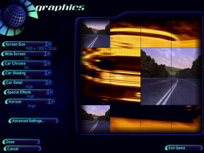

I found a workaround for the resolution limit. Relevant steps:
  1. Install NFS3 from the disc (choose Maximum installation)
  2. Apply the official Banshee and Voodoo 3 patches, in that order (download both from Soggi's website)
  3. Run the game's 3DSetup.exe and select Direct3D Device 1
  4. Download the NFS3 Modern Patch, extract the archive contents, go to the drivers/dx6 folder and grab dx6a.dll
  5. Rename dx6a.dll to voodoo2a.dll then copy it over to the NFS3 folder
  6. Edit the NFS3 desktop shortcut to add the -voodoo2 parameter
  7. Run the game using this edited shortcut
The attachment NFS3_Shortcut.jpg is no longer available
The attachment NFS3_HiRes.jpg is no longer available
You can now select up to 1600x1200 for the resolution from the game options menu. Fog will also work, even on Radeon cards. And of course, you can play the game under Win9x with fully functional EAX. 😀
P.S.
This also works without using the DLL from the modern patch, and simply renaming the game's own d3da.dll to voodoo2a.dll. However, this will limit the resolution to 1280x960 and won't have working fog. The in-game fonts will also be more blurry.

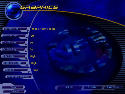

Reply 574 of 653, by Joseph_Joestar
Similar steps for NFS4: High Stakes
  1. Install NFS4 from the disc (choose Full installation)
  2. Apply the latest official patch 4.50
  4. Download the NFS3 Modern Patch (it's newer than the NFS4 Modern Patch), extract the archive contents, go to the drivers/dx7 folder and grab dx7a.dll
  5. Rename dx7a.dll to d3da.dll then copy it over to the NFS3 main folder and its 3DSetup subfolder
The attachment NFS4_HiRes.jpg is no longer available
You can now select 1600x1200 (and higher) for the resolution from the game options menu. Fog will also work, even on Radeon cards, and of course you get fully functional EAX under Win9x. 😀 As a special bonus, this will prevent the game from crashing when ATi Catalyst 6.2 drivers are used. Same goes for Nvidia 45.23 drivers.

Reply 575 of 653, by Sombrero
Joseph_Joestar wrote on 2024-06-23, 12:29:
I don't understand at all how you can just swap a glide dll to a d3d dll and I understand even less how on earth did you even figure all that out, but it works great! Nice job!
Had a little trouble first, turned out it doesn't work with 1.02 version of NFS3. Don't know why, maybe the 1.02 patch does something to the -voodoo2 parameter functionality or something. Figures, I just literally days ago found out there even is a 1.02 patch for the game that someone put together ages ago since EA didn't release stand alone patches and expected people to use the auto updater to fetch patches. Installed it hoping it would fix the odd crackly noises I get with EAX sound occasionally with this game, but no go.
At least now I don't have to choose between fully issue free EAX and high resolution and can go back to version 1.0 and use this trick. Don't know what that 1.02 patch does but since I haven't noticed any difference between it and 1.0 I doubt it's anything major.

Reply 578 of 653, by Sombrero
Joseph_Joestar wrote on 2024-06-24, 00:45:
Does replacing EACSND.DLL with the version from NFS4 help with that? I don't remember encountering any crackling on my system, but I haven't played the game extensively (aside from testing) in quite a while.
Unfortunately no, complains about version mismatch. Wants version 18.3 and the version from NFS4 is 18.5. Good idea though, I should have realized to try that myself after all that renderer swapping. Oh well, the crackles aren't too obnoxious. They sound like someone would physically twist my headphones a little every now and then, giving off that kind of crunchy snap sound.
That's been happening on every system I've tried, with SB Live! and SB Audigy 2 on Win98SE and even SB X-Fi Titanium on WinXP with the modern patch, all with completely different driver versions. No idea why, I've been assuming it's a bug in the game but if no one else is having that issue then beats me?
But I did get the 1.02 version to work with the voodoo2a.dll trick, looks like my hunch about the -voodoo2 parameter not working was right. I found out that you can get a list of available parameters by nfs3.exe -?, which does absolutely nothing with version 1.02 but prints out a long list of parameters with version 1.0.
The solution was to swap the HKEY_LOCAL_MACHINE\Software\Electronic Arts\Need For Speed III\Thrash Driver to voodoo2 in registry.
Anyone interested in the 1.02 patch can find it here
Note that it only installs on US version of NFS3, I haven't been able to find an european version. It just doesn't like the EU exe so you just can swap that to 1.0 US exe and you are good to go. Also the update.bat seems to have formatting issues so either edit it on Win98 before running it or run patch.exe nfs3wm_101.rtp followed by patch.exe nfs3_102.rtp manually in MS-DOS Prompt.

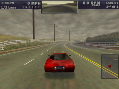

Reply 579 of 653, by Joseph_Joestar
Sombrero wrote on 2024-06-24, 06:21:
That's too bad, I hoped it would have been an easy fix, just like with the renderers. On the plus side, I managed to get the fog working in NFS3 on Radeon cards:
The attachment NFS3_Fog_9600XT.jpg is no longer available
I've edited the original post with the updated steps. The only change from the previous approach is that you use the dx6 renderer from the modern patch instead of the dx7 one. No extra fog-related tweaks are needed for Radeon cards, it works fine with all driver settings at their defaults.
At last, we can play NFS3 at 1600x1200 fully maxed out under Win98, with working fog and proper EAX. 😀
bloodem wrote on 2024-06-08, 18:14:
Great find! Thank you, Joseph! 😁
I figured I'd tag you again for the most recent NFS3 fog restoration. 😁 The game visuals now look great on Radeon cards, with high resolutions available if desired.
