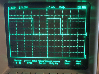

If I probe pin 18 on a normal, working drive I see the correct DIR while seeking:
The attachment 20240626_145204.jpg is no longer available
However, when this drive is plugged in, the DIR line never goes low and my scope does not trigger - something is pulling it high and keeping it high. This of course makes sense as the cause for why it's doing what it's doing.

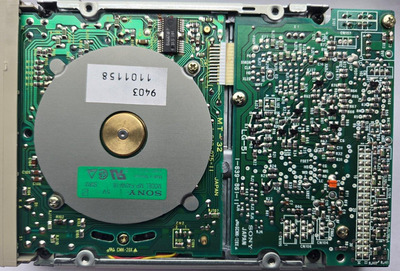

Attaching a photo of the bottom for comparison to the ones in the previous post.
Would love any thoughts or suggestions for what to look at next. I really don't want to give up on this drive!

Correction 1: Testing more closely, it does not appear that DIR is being held high all of the time. What's happening is actually that the BIOS is doing a recal operation during POST test, which is supposed to seek outward until it hits track 0, but since it actually seeks the other way it never hits track 0 and never reverses direction (DIR low). If I step up or down in Image Disk, I can see that the DIR is going high and low accordingly, but the drive is only seeking inward.
Correction 2: I incorrectly said above that it only steps "outward" rather it only steps "inward" - towards the middle, towards track 79.
