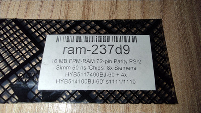

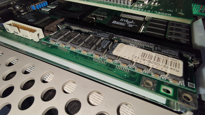

Reply 7 of 10, by biessea
Hi, I am coming late here, but I never seen this thread!
I have the same machine, and I can say I learned a lot from it, and then thanks to my friend I upgraded too.
Beginning about the RAM, yes the system has originally 4mb of RAM but you can expand with more RAM in that slot, remember to put a parity module here, I upgraded with a 16mb of RAM. I put the photo of the module I bought. It runs perfectly.
About the graphic part, the Cirrus Logic GD5428 chip can be upgraded with another 512kb of Vram yes, I will put the photo of exact module that you have to find in the attachments. Now Windows 3.11 can run in higher resolutions!
I made the battery replacement too, as you did I see.
If you need I have the floppy image of the setup disk that you need to enter and write cmos of the system.
I put a Sb Awe64 on the ISA slot to have better sounds too.
The system now works flawlessy, and it is beautiful!
    165.81 KiB
    703 views
    Vram memory module
    459.01 KiB
    703 views
    Fhe 16mb memory module
    566.78 KiB
    703 views
    Memory modules tags
