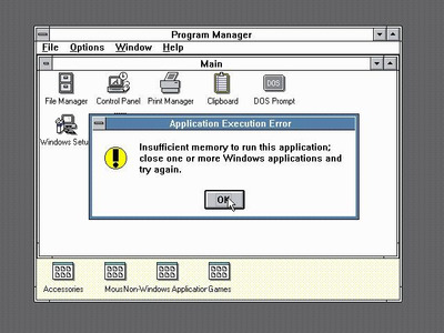

Reply 49 of 50, by ks4
Hello, very cool project.
I know that it's not main aim of this driver, but I tried running your windows driver on real PC under real mode Windows 3.00a and encountered some problems with it. Recently I found that real mode windows can be easily run under Windows 9x DOS box. So I started experiments with some Windows versions inside Windows 98SE. There is only one problem that every "Windows in Windows" have - mouse don't work. This is caused by Windows 9x driver which takes full control over hardware not allowing any other similar driver to work. In DOS Window there is only posibility to use int 33h interface with mouse driver provided by Windows 9x VxD. So I found some drivers that use DOS int 33h passthrough to Windows. Your driver was the best candidate, because it was the only one to work in real mode Win 3.0. I found that only versions shipped with vbados package works. The standalone vbmouse version starts, but mouse don't move. In vbados I just load VBMOUSE.DRV to SYSTEM.INI and don't use VBMOUSE.EXE, because it can't be loaded on 9x (Windows just ignores it, still using it's own int 33h implementation), but vbmouse.drv seems to accept that fact. The only problem is that it causes "insufficient memory error" on some programs, despite having still about 400k free.
81.24 KiB
979 views
Not all programs are affected. The ones I found that display this error are for example windows setup program, calendar, PIF editor, Word 1.0 for Windows. They are always the same. Rest work normally, even games like soltaire and reversi work stable without any slowdowns. I tried to compile this driver on my own with disabled all unnecerssary functions like scrolling, VBox integration features, even 386 enhancements, leaving only bare driver, but it still causes the same error. I also checked it with disabled initialization in code (I set flags.enabled to true without initialization) and with driver not functioning only loaded in memory it still causes errors. Removing driver from system.ini solves problem, so it's definitely something with it. I also checked it in pure DOS without loading Windows (with all VBMOUSE.EXE, CTMOUSE.EXE and standard MS MOUSE.EXE) and still the same. Maybe it's problem with driver memory management?
On the other hand I checked this driver in WfW 3.11 standard mode loaded in Windows 98 DOS box with some beta Windows 95 files. Normally it uses special Microsoft driver dualmous.drv but I checked your driver and it worked even better, not causing any GPF's (like dualmous.drv) or slowdowns (like i33mouse.drv which I also tried). So from my experience the problem exist only in real mode Windows 3.0. I know that this driver wasn't aimed at real hardware, but it has very big potential, being close to perfect running in such unstable and crazy environment. Have you any ideas what could be wrong?
Reply 50 of 50, by javispedro1
ks4 wrote on 2024-07-21, 20:48:
Interesting, I didn't know that. Win3.x virtualizes the PS/2 hardware so inside DOS boxes programs can read the PS/2 mouse as normal, it's interesting they dropped that in 9x.
You can make w9x fall back to the w3.x keyboard stack (vkd, vmd) if you install a w3x mouse driver in 9x. (e.g. just put vbmouse.drv in 9x's system.ini 😀 ).
I have verified that this makes 9x go back to 3x-like behavior: it will stop providing its own int33 driver in DOS boxes and will allow (virtualized) PS/2 access, so classic DOS mouse drivers will work....... and perhaps including win3 in real mode with its standard PS/2 driver ? Maybe worth a try...
The issue seems to be that vbmouse.drv calls LocalInit (as part of watcom's DllMain; not my code), and this makes Win3.0 unhappy for some reason.
You can manually hack the NE header to set the "Local Heap Size" to 0 and this will prevent the Watcom runtime from calling LocalInit. This will avoid the "out of memory" messages, but it also seems to cause the driver to crash, and I have not figured out why yet. Maybe the runtime does use the heap. That would explain why it is built with a non-zero local heap size even though the documentation says the default should be 0.... this requires some long look at the watcom runtime and I haven't had the time.
