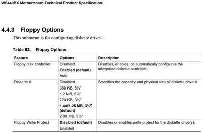

Reply 23 of 26, by dormcat
Cursed Derp wrote on 2024-08-10, 13:29:
Is this thing any good https://www.ebay.com/itm/256589690331
https://theretroweb.com/motherboards/s/intel- … bx-warm-springs
39.03 KiB
261 views
Looks like a common problem of OEM motherboards back then. 😏
