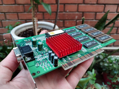

Nexxen wrote on 2024-08-10, 21:11:
The red heatsink alone is gonna up it up up to 1.56FPS. (mine is a joke but maybe it's true :)) Smart choice ;) […]
dominusprog wrote on 2024-08-10, 19:46:
Recap this A-Trend S3 ViRGE and also add a red heatsink 😁.
The attachment IMG_20240810_173628.jpg is no longer available
The red heatsink alone is gonna up it up up to 1.56FPS. (mine is a joke but maybe it's true 😀)
Smart choice 😉
Looks way nicer than stock, good job!
Thanks, much appreciated. The thermal design must be in the ballpark of 40–45 °C, so a heatsink definitely helps.

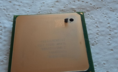

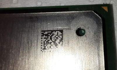

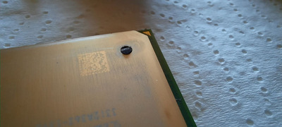

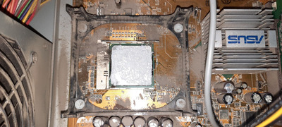

I wanted to take a p4 3ghz cpu out of a pc that i got for next to nothing together with some other stuff. Seemed to have been some kind of homeserver or whatever. It's been in the attic for a few months and just now though i'd get the cpu out to put in an ABIT IS7 i bought some time ago.
Well it almost needed digging out ... then i noticed the vent hole was plugged and wondered what i could do to get the thermal paste out without poking in it and getting it to where i can't reach. Enter the Solder sucker with flexible tip. Worked like a charm.

Reply 28114 of 31619, by StriderTR
Game testing, lots and lots of game testing on my DOS 6.22 machine.
Had some issues with with games crashing, not launching, or having no sound, but I think I've got a vast majority of that sorted out. So I'm going through and removing the few games left, that no matter what I do, just don't want to work properly, and installing more that I want and testing them out. My trusty old GoTek is really getting a workout.
I did just realize today that I don't have a proper 2 drive FDD cable on hand, just the single drive cable I'm using on the GoTek. I could have sworn I had one, but I went to swap out the cables today and realized I was mistaken when I dug through my box of ribbon cables and them all to be IDE. Guess I'll need to get one off Amazon if I want to run both my GoTek and standard floppy drive at the same time. Kinda sucks I have to drop $10 or more on one, but, it is what it is I guess.
DOS, Win9x, General "Retro" Enthusiast. Professional Tinkerer. Technology Hobbyist. Expert at Nothing! Build, Create, Repair, Repeat!

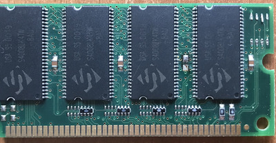

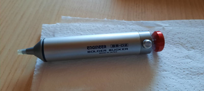

Reply 28116 of 31619, by PC@LIVE

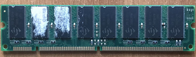

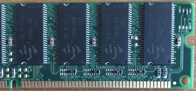

Yesterday I tried to repair a 64 MB RAM module (PC100???), initially I thought I had only one problem, an SMD capacitor was soldered male, rotated 90 degrees, a fairly easy job for those familiar with soldering , unfortunately when removing it, it fell off the counter, and I couldn't find it.
If it was a particular component, I would have had trouble finding one, but I think it's not particularly difficult to find it in a scrap MB.
The second problem I identified yesterday is the lack of the SPD chip, which has four contacts per side, and was located at the top right.
I have no idea if this SPD is indispensable, i.e. if the RAM can work without it, it was suggested to me to recover one from an unrecoverable module (perhaps similar), but not knowing what chip it was, not so if there may be differences.
Any suggestions in this regard are welcome, also because I do this repair, as a hobby and for a change, since it usually protects MB, this RAM could be useful in the old S.7 PC.

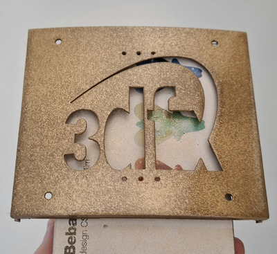

Reply 28117 of 31619, by iraito
I'm finishing up the last 2 pieces for my P2/awe64/voodoo2/matrox g200 PC case.
This is the one I spent more time working on and the last 2 pieces are finally painted decently.
Still drying but it was totally worth it.
MIDI Devices: RA-50 (modded to MT-32) SC-55
