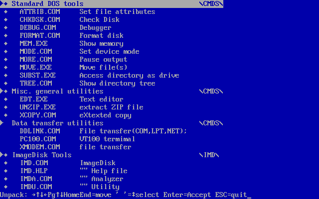

Reply 64 of 81, by DaveDDS
aazard wrote on 2024-09-10, 19:29:
Additional thought for (semi-related) "easy PC-DOS 7.1 Rev 0 BLD134 install disk".
FWIW - maybe this will give you some more ideas:
(please keep in mind that I'm trying describe something I did MANY years ago!)
Back in the day when I distributed software on both "floppy disks" and via
emailed installers - I wanted to keep things as small as reasonably possible,
I thought about self-extracting .ZIPs, but decided not
to got that route for a few reasons:
- Not workable for non-executable files.
- You don't have as much control as I would have liked in unpacking and
placing the files.
- You include the extraction code with every executable.
What I ultimately did was to create my own file archive/compress tool: MAR
(MicroARchiver) - I don't think it compressed quite as well PKZIP, but it didn't
need to include the decompress code with every file, and it was completely
under my control. Also, I could put the decompressor, menu based selection
code AND all of the compressed files into a single .EXE on my install disks.
For many years I did not publish MAR or it's format spec. but as part of my
retirement "publish everything I can that I wrote over the years), It is now
available in the source code are of my site.
You can still see a good example of this in the "bootable" version of ImageDisk
that I have at: DavesOldCompuresr -> Software/Images -> Bootable diskette - IMD
It is designed to boot DOS with optional support for CD/DVD, USB mass-strage
and unpack various tools and utilities including DOS tools, FileTransfer and
Networking, and ImageDisk with it's tools onto a RAMdisk that you could run
things from ... I did this mainly to allow ImageDisk operation on systems which
didn't have DOS installed, but you can boot it anywhere as it doesn't "install"
anything.
Attached "BOOTIMD.TXT" has a list of whats on this diskette with a bit of
description.
Dave ::: https://dunfield.themindfactory.com ::: "Daves Old Computers"->Personal

Ok, I've tossed together a little "more general" package install/unpack tool.
If it's close to what you want, let me know and I'll get it published on my
site.
It uses a (text based) .PKG file which describes the package content and how it
should be unpacked (I've attached TSTPKG.TXT which is TST.PKG one I created
for a "test" package I've been using it work with it - there are comments within
describing the entries)
When you run MKPKG:
E:\PKG> mkpkg tst
PCDOS\ATTRIB.COM 2702

Most lines show the files it's adding to the package (shown in "real time"
with twirling /-\- while it's working) then either number->number indicating
how much the size compressed. or a single number indicating that this file
couldn't be compressed.
Note that most of these files are precomressed executables (which I often do
for bootable disks to reduce floppy disk size - for .COMs I usually use my own
tool, or for .EXEs UPX) - so most didn't further compress much!
The last line shows the TotalUncompressedSize, TotalCompressedSize and Exe
file size (6508 is the actual .EXE, 858 is the header with names and other
information it needs) the final number is this + Tc=
This generates <package name>.EXE (in this case TST.EXE) which is the ONLY file
you need to "give out" to that others can install your stuff!
Here are the files:
24-09-14 9:33a 15,259 MKPKG.COM
24-09-14 9:15a 1,424 TST.PKG
24-09-14 10:05a 263,173 TST.EXE
Note that although TST.EXE is BIG, that's because it has the compressed package
data appended to it - when run, it only loads 6508 bytes into memory, gets the
rest by reading the .EXE file (Thats why I used .EXE as .COM which I tend to
prefer for small programs would try(and fail since it's >64k) to load the whole
thing into memory.
Attached MKPKG.PNG shows what you see when you run TST.EXE
|> symbols on left mark sections/groups of files, and lines beginning with ' '
are the files in that section. <> (diamonds) indicate which files are selected
to be installed. You can press SPACE to toggle selection of individual files,
SPACE on a section selects/deselects all files in that section.
The white bar at the top is the selection marker which moves up/down to show
"where you are" - screen/items will scroll as needed.
ENTER unpacks/installs all selected files, ESC quits.
Suggestions/feedback are of course welcome!

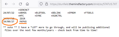

Reply 78 of 81, by xa3d
STATUS.TXT reflecting wrong date [future date to be exact] on https://dunfield.themindfactory.com/dnld/sc/STATUS.TXT
    12.66 KiB
    487 views
Reply 79 of 81, by Horun
xa3d wrote on 2024-09-21, 16:15:
He missed typed, "MKPKG MaKe PacKaGe installer (24/9/17 22.1k)"
