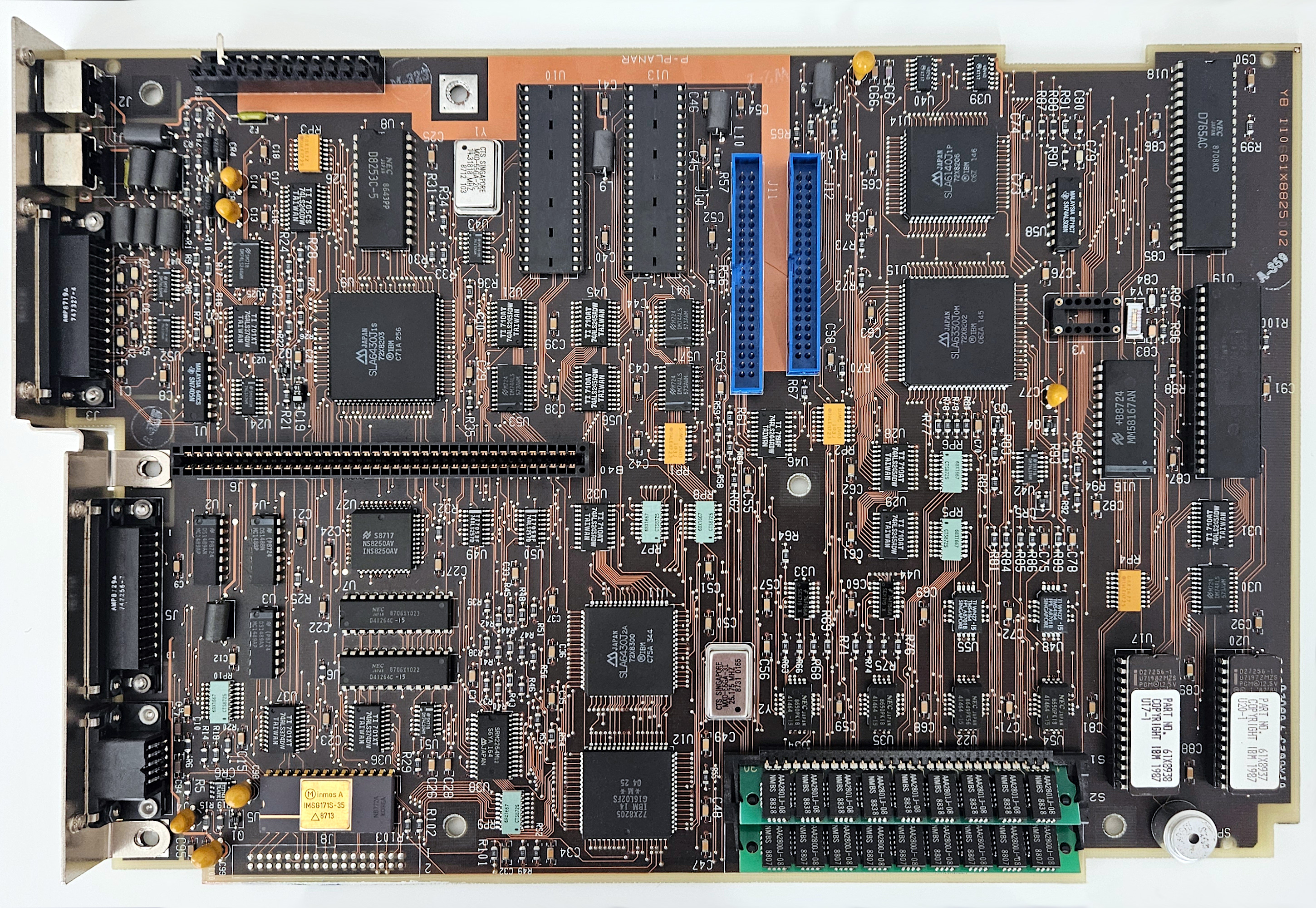

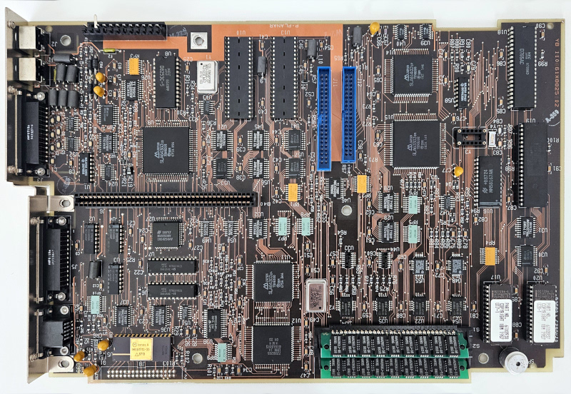

Reply 2292 of 2512, by pshipkov
IBM PS/2 Model 30 8530 P-Planar
Rules exist for a reason, and breaking them has consequences.
In the realm of computing, I've found it beneficial to maintain a distance from major North American brands like IBM, Compaq, DEC, Apple, Dell, HP, Gateway 2000, and so on.
IBM's Model 30 boards were once so common that they can still be acquired inexpensively today. Decided to examine one, specifically the Model 8525.
It features a non-standard power connector, which mostly aligns with the AT standard except for one pin that needs to be changed from +5V to GND.
Notice how on the brown board, this pin is bent, and it is entirely missing on the green board (it broke off).
The 8525 board never functioned correctly; I couldn't test anything on it, and it eventually stopped working altogether. I didn't attempt to repair it because I didn't know where to start. It is now with another forum member. Hope he resurrects it.
I acquired a second board, the green 8530 mentioned above. This one worked well initially. Early tests showed good functionality, but it didn't overclock well, which is important to me.
At 11MHz, the keyboard controller would hang the system during boot. Tried different KBC chips, but the assembly only accepted type 5 controllers, regardless of brand. Found a few different chips from AMI, Intel, and NEC, but none could overcome the 11.68MHz limit set by the 70MHz oscillator with a frequency divider of 6. The board accepted the NEC V30 CPU without issue, which can exceed its 16MHz rating, but running it at mere 11MHz was frustrating.
Eventually, I realized the system clock oscillator (in the upper right corner) could be hot-swapped after booting to DOS. I used a frequency multiplier from Migron that fits a can-4 socket. This resulted in 24.535*3.33 = 13.68MHz. Better, but far from great.
The next step was to see if the 150ns on-board RAM chips were too slow. It was unlikely but who knows really. Replaced the four 41464 chips with 80ns versions, and the board died. Hard. Couldn't revive it. Cannot identify what and where went wrong.
I'm decently ok with tools and electronics repair, so I know it wasn't me. I was particularly cautious because, with two boards, I noticed how fragile they are. The PCB is flimsy, bends, bubbles and melts even with modest heat gun use.
Acquired a third board, the brown one above.
Interestingly, it didn't power up with the NEC V30 CPU, which was unexpected. After probing with an oscilloscope, I determined the issue was likely related to the 72X8202 chip. Notably, these chips differ between the two boards.
Initially, the Japan-made SLA6330J was on the now-dead green board.
Swapped the chips, which caused the brown board to fail too. This was baffling. Probing with a multimeter confirmed all pins were properly soldered, but some signals were apparently incorrect. I had some flux residue around the swapped chip and between its pins. This had never been an issue before, so I initially dismissed it, but eventually, I decided to clean it off. Hot water and a brush do the job. After drying the board and plugging it in, it worked immediately. Perplexing.
The brown board with the NEC V30 CPU was still limited to no more than 13.68MHz. I captured results from standard benchmarks at 10MHz (normalized) and peak 13.68MHz, but performance was meh. Decided to carefully upgrade the on-board RAM. After doing so, the board failed, just like the green one.
Very frustrating, but got the memo and decided to stop here.
So, to summarize:
8525: Odd power connector that maps to AT. No MCGA connector, only on-board pins for it. DIP on-board RAM, making it easy to upgrade with faster chips.
8530: Standard AT power connector, easy to use. Proper MCGA connector, easy to use. PLCC on-board RAM, difficult to upgrade.
Poor PCB quality.
Limited to one type of keyboard controller.
Some boards don't support NEC V30 CPU upgrades.
Sensitive signal processing; a bit of flux presence and no lights.
I usually respect and appreciate these vintage electronics and the engineering behind them, but the IBM Model 30 motherboards are just too bad. Anyhow.
Tested with:
NEC V30 16MHz
Diamond SpeedStar 24 (ET4000AX)
640KB RAM (first 128KB are 150ns, the rest are two sticks with 80ns chips)
XT-IDE controller with CF, DOS 4 and 6.22 (no performance difference)
Performance is unimpressive for an 8086/V30 system.
benchmark results
EDIT: If somebody wants these motherboards - PM me and they will be yours for a shipping cost.

Reply 2293 of 2512, by feipoa
These IBM Model 30 boards sound troublesome and sluggish. I'm surprised you persisted with 3 sample motherboards. Perhaps there were some subtle differences between your 150 and 80 ns memory which caused the failure. I remember once using some memory modules on an M919 board which killed it. I later replaced the northbridge on that board and all was well.
Regarding your flux residue causing issues - was it no-clean flux? Apparently, no-clean flux should be fine to leave on the PCB. Check your solder roll to see if it says 'no-clean' anywhere on it. If not, then maybe this is why you had to remove the flux.
I'm surprised you also used the same board-killer RAM on your 3rd Model 30 motherboard. Did you also try putting the 150 ns RAM back on the MB to see if the board came back to life?
Regarding - Some boards don't support NEC V30 CPU upgrades - Did you swap BIOSes between the boards to see if the issue was BIOS related?
Reply 2294 of 2512, by pshipkov
The first one was flaky. That was long time ago, so cannot even remember what was exactly wrong with it. Gave it to another forum member to struggle with it.
Yes, there is something off with the 150/80ns memory chips. Sounds similar to your experience with M919.
I use LaCo regular soldering flux. It is old, but want to finish it up before opening a fresh one.
So far it never gave me trouble, but going forward i am going to watch it.
It took a third dead board before it clicked with me that the RAM is killing it, or so it appears to be.
Reverted back to the original 150ns chips, but it was too late.
Swapped BIOSes between the boards. Also downloaded some microcodes, but it is not the BIOS it is one of the boards not licking the V30.
This one feels like quality control failure.
