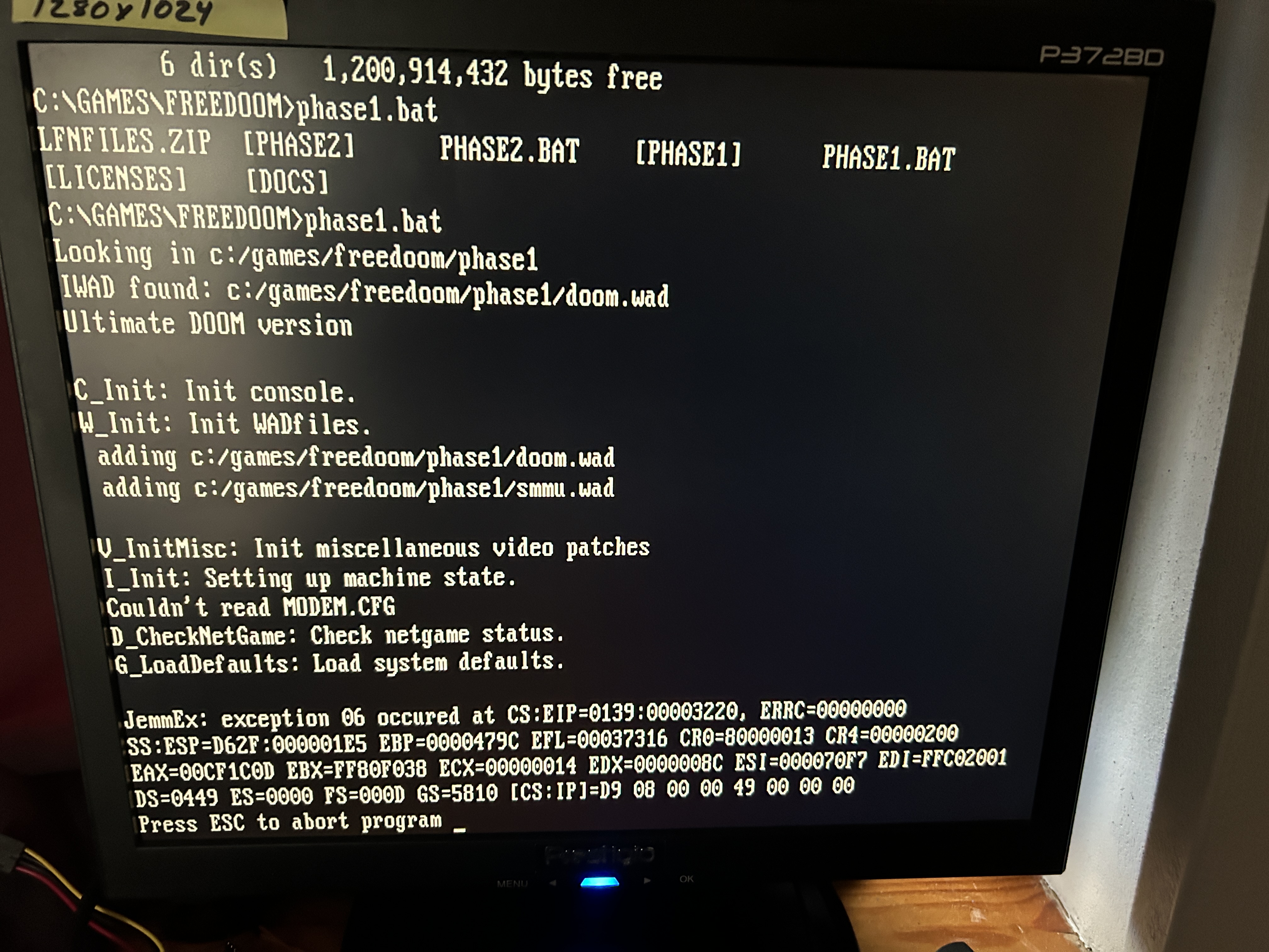

Hey all, so when SBEMU is loaded all games FREEZE. I am running FreeDOS 1.3 and the games I am trying are the games installed form either the FreeDOS 1.3 install CD or Bonus CD. I have tried BOOM, FREEDOOM, WING, and QTETRIS: none will start, starting freezes/hangs. Sometimes I can ctrl-alt-delete restart but sometimes the entire PC is frozen/hung and I have to use the power switch to reboot. When SBEMU is NOT loaded, these games run fine. Any suggestions appriciated. Thank you!

Possibly run HDPMI32I with the "-r" flag to make it resident, so that DPMI apps that get started will use HDPMI instead of their default extender. Might not have an effect on real mode games, but protected mode games.
Reply 1596 of 1799, by SYZYGY
thp wrote on 2024-10-09, 06:02:
SYZYGY wrote on 2024-10-08, 12:55:
Hey all, so when SBEMU is loaded all games FREEZE. I am running FreeDOS 1.3 and the games I am trying are the games installed fo […]
Thanks but sadly that didn’t help. However I now get an error before it freezes/hangs.

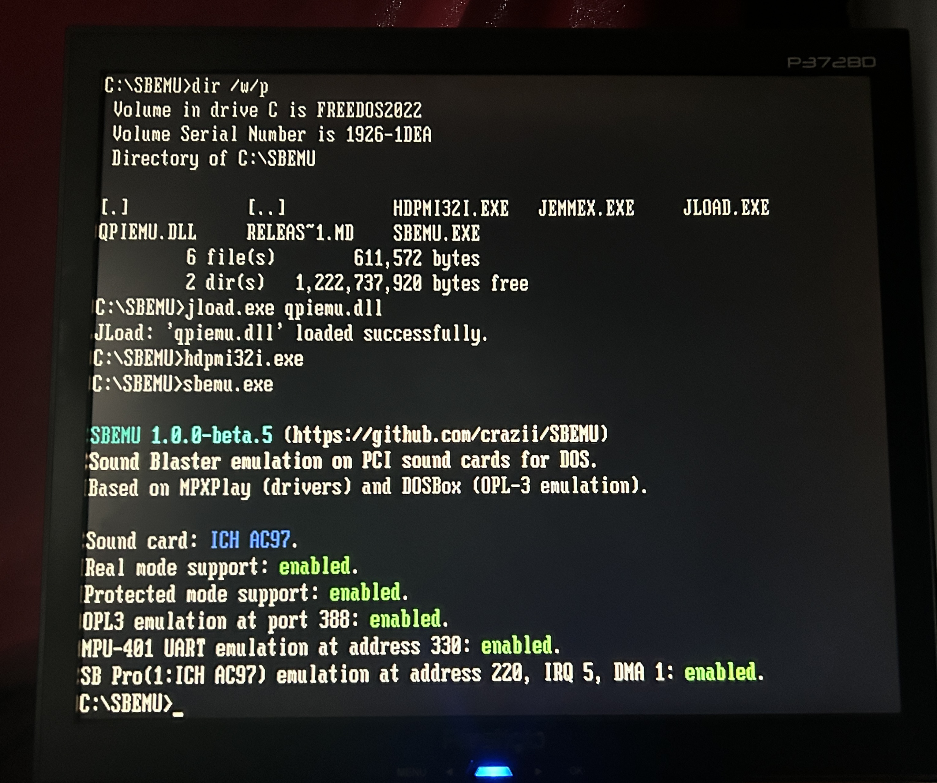

Reply 1597 of 1799, by Methanoid
This is one of the most frustrating experiences ever... I've tried FreeDOS and MSDOS... the FreeDOS IMG provided by Crazii seems to have some problems (I raised ticket at GH, no response).
The best "guide" I have found is here https://www.jamesfmackenzie.com/2023/03/22/ho … able-usb-stick/ so now I can boot FreeDOS, I have JEMM and HDPMI32i loaded and I see my FirePro W7000's HDA fine. Blaster emulation shows up with IRQ7 for some reason. But getting a game to test it works is proving a challenge
I tried Doom (Shareware) and it sticks on the DOS4GW loading and when I press a key it errors and asks if I want to abort. Yes, says I, and then text scrolls at FTL speeds up my screen and I have to hard reset
I tried DukeNuked3D (Shareware) and the installer hangs with error 200 (so cannot even try the game)
I tried EOTB and there seems to be no sound in the game and no setup prog to check what settings so I used SET BLASTER=A220 I7 D1 in case it needed it but no sound
Can someone PLEASE tell me a program that (a) works and (b) readily available and (c) allows settings to ensure it will work with IRQ7 rather than more common IRQ5. I just wanna SEE if I can get sound before I invest half my life installing DOS or Win98 to be able to play some old games.
Reply 1598 of 1799, by myne
Why are you so married to irq7?
