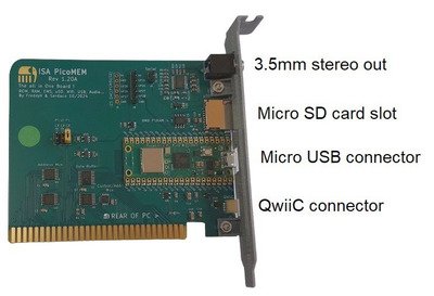

I made a special edition PicoMEM Audio Edition", with the PCM5102A stereo DAC integrated on the PCB
https://www.serdashop.com/PicoMEM

This looks great.
Any chance of a version that will be compatible with the old systems that have an external ISO expansion (like the Ollivetti PC1 or the Schneider EuroPC)?
This model will most likely not fit the expansion due to the support for the bracket.
