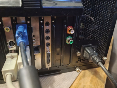

RCA mod is simple, no need to modify SB16 at all. I take the stereo out from pcb to another bracket.

It's interchangeable both ways. I can take SB16's line out to the wavetable header of Picogus, and route RCA bracket to Picogus.
I just have not tested it because volume controller at Picogus is still on the way, but can test Picogus->SB16 right now.

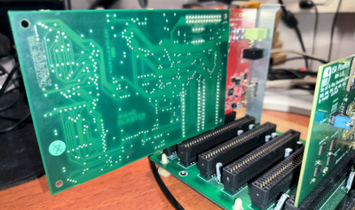

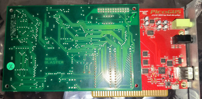

ct1900 fits without any problems 😀

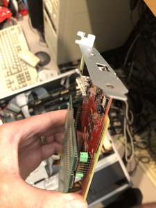

How did you get it to fit? The jumpers are in the way
