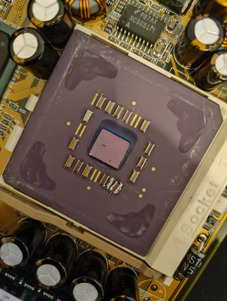

Just wanted to share that I successfully modded a 500MHz ACZ core. Those seem to be the only ones left on eBay.
IHS came off easy enough with a razor blade. I went slow, did a little bit on a corner and went to the next, and did several rounds of that, then it popped right off. Just a little cleanup and it was good.
I left the IHS off. I added some rubber strips at the corners that were about 0.7mm thick. They work a lot like the later Athlon pads. I was able to push it to 600MHz at 2.4 volts stable with an hour of Prime95.

Reply 605 of 651, by brain_recall
Yeah probably too high. It's stable for Prime95 but was giving me trouble in some games. I dropped it down to 550MHz which it can do at the stock 2.0V with no issues.

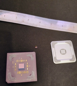

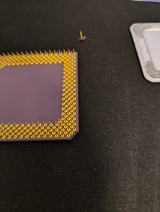

think i done f*ed up. Was trying to take off the lid using a steel ruler and managed to snap of a pin on the opposite side of the inserted keyed edge. Put it into the mother board and it still posts. Does anyone know if that pin has any significance?

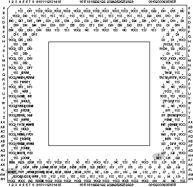

Seems like it's AN37 pin - Vss i.e. connection to ground. One of many others, so no problem.

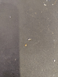

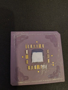

....and its dead, janky soldering resitor blob, suspect overheating 500c solder iron....

Reply 609 of 651, by analog_programmer
gmaverick2k wrote on 2024-11-24, 14:36:
Looking at last picture it seems like you chipped the crystal.

Reply 610 of 651, by gmaverick2k
analog_programmer wrote on 2024-11-24, 14:54:
Rust in pieces K6-2+.
-_-'
damn...
tried to resus it... cpu down... RIP
I cant solder for sh**..

Reply 614 of 651, by Sphere478
Heating the cpu first like with a hair dryer or a heating bed helps.
Yeah, there is a lot to go wrong when doing this. Be careful.
Indeed that lost pin is a power/gnd pin so not super critical. Who knows what else it may have broke though.
And as others said, chiped die. 🙁
There are people selling modded ones if you look around. Or you could try again. Sorry.
