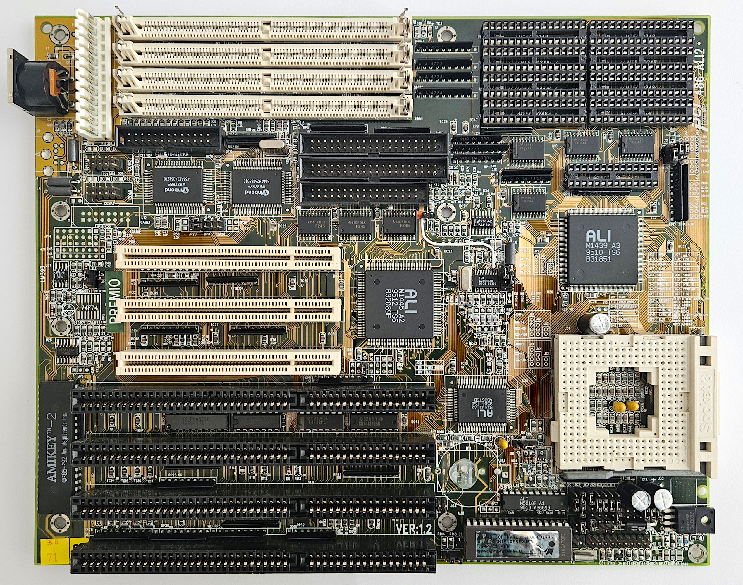

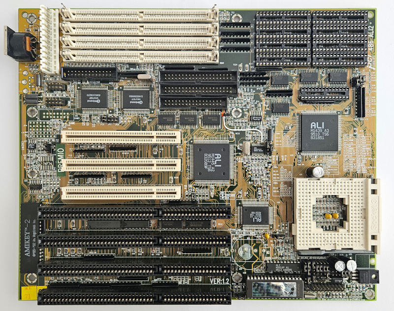

MSI-4143 ver:1.2 based on ALi M1445 A2, M1439 A3, M1431 A2
Chipset date stamp points to year 1995. So the assembly is made in 1995 or later. Kind of late for this version of the ALi chipset.
Clock generator offers 60/66/83MHz frequencies. Added a third jumper to unlock them.
Despite the two banks of 32-pin level 2 cache sockets the maximum buffer the board can take is a single bank 512Kb. Ran with that. It is better than dual bank 256Kb.
Jumper settings are a bit confusing. Takes a moment to figure out what's what.
Leaving a note to myself here that JC3 in position 5-6 sets the CPU clock multiplier to 2 (4). Leaving it open sets it to 3.
Came with an AWARD BIOS with lots of timings exposed but all of them permanently locked. First time seeing this kind of stuff. Why make them visible in the first place?
In addition - this BIOS does not recognize Matrox PCI video cards. Other video adapters seem to work just fine. For the sake of consistency i test all 486 PCI motherboards with Matrox Millenium (MGA-2064W) cards which sent me on a search for other BIOS versions that resolve the problem. Luckily multiple of them are available. The one that worked best is AE95E, including with Matrox cards.

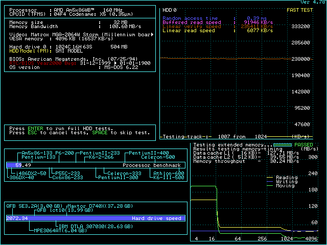

--- Am5x86 @160MHz (4x40)
All BIOS settings on max.
SpeedSys, with skewed IDE metrics:
DOS performance is intermediate at best.
Had to reduce timings significantly to get Windows under control, but the very sensitive LightWave3D offline graphics test (in Windows) was unstable no matter what.
benchmark results

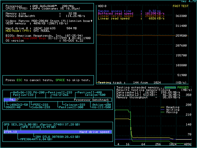

--- Am5x86 @200MHz (4x50)
System is barely stable despite all precautions taken - trusted components used and 12V Peltier to hard-freeze the CPU.
Most BIOS settings can be left at their most aggressive values - does not have impact on stability. The 4 settings that improve stability somewhat are:
DRAM READ TIMING = FASTER (best is FASTEST)
DRAM WRITE TIMING = NORMAL (best is FASTEST)
CYCLE CHECK POINT = FASTER (best is FASTEST)
IDE DRIVE SPEED = 33 (best is 20)
SpeedSys:
Will not update the combined benchmarks for 200MHz.
The few numbers i was able to collect are:
Wolf3D: 110.7 fps
PC Player: 25.6 fps
Quake 1: 17.8 fps

All in all not a great assembly.
Intermediate performer when in functional state. Does not overclock at all.
