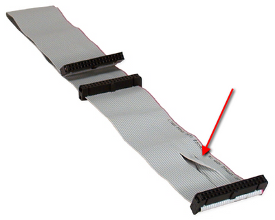

This is probably a very easy question to answer.
Could 3.5" diskette drives run in parallel on the same channel in like in a master/slave configuration like IDE hard drives did? Or was it always separate channels, cables, and connectors on the motherboard if you wanted to have a B: drive?
Reply 1 of 9, by megatron-uk
Floppy disks (almost always) run on the same cable, with a twist in the cable being used to make one of the drives respond to drive b: compared to drive a: - this is why you (almost never) have to jumper a floppy drive as a: or b: ... it's the position on the cable which determines it:
The attachment VYByP.png is no longer available
Yes, there are exceptions, especially if using floppy drives not originally intended for PC use, but the above is true in 99% of cases, and it meant that manufacturers could send out their disk drives all jumpered/configured for drive a:.

Reply 2 of 9, by InterClaw
megatron-uk wrote on 2025-01-10, 08:58:
Sweet, thank you! When I see the picture I do remember those cables now. 😀 Now I just gotta see if I still have one like that to try it out.
Do you also know if it's possible to run with just a B: drive, if you really wanted to?
Reply 3 of 9, by jmarsh
If you want the drive to be B: just use a straight cable. A: drive requires the twist.
Reply 4 of 9, by InterClaw
jmarsh wrote on 2025-01-10, 10:20:
Got it, thanks!

Reply 6 of 9, by Errius
3.5" drives are configured for B: by default if I remember correctly, but the twist at the end of the cable causes that drive to be seen as A:
