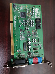

Hello everyone
I have 4 Micron computers and I would like to run some utilities on them like HWinfo32 or others. When I look on Major Geeks I only see modern versions of utilities. I have a AN430TX , a 440LX, a 440BX, and a D815EEA motherboard. All of these motherboards seem to have on board Yamaha sound. I think it is interesting however; I can't get Shadow warrior to play music. On the AN430TX I used several sound blaster cards in different ISA slots and everyone of them used High DMA 16 IRQ 3. I tried them in all 3 ISA slots and could not change the IRQ from 3. Even using sbset in dos and changing the IRQ I keep getting the same IRQ error in Shadow Warrior set up. When I did find a site that said they had HWinfo32, when you downloaded it, it was HWinfo64.
If anyone has any ideas or suggestions I would appreciate it.

I really was hoping this card would work. It is a Sound Blaster 16 Waveffects. I put it in all 3 ISA slots and windows 98 always said it was using IRQ 3.

Reply 2 of 5, by Tiido
you'll have to manually reassign the IRQ and may have to juggle other IRQs to free up the one you really want to use.
Reply 3 of 5, by megatron-uk
Isn't Shadow Warrior a CD-audio game? I don't think the registered version uses FM/MIDI music, does it? It's been a long time since I played that one.

Reply 4 of 5, by Tiido
Right, that is definitely the case. You can hear the MIDI/FM in the setup program, but game itself uses CD audio.
