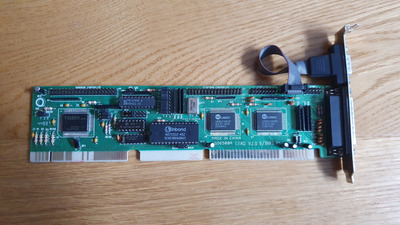

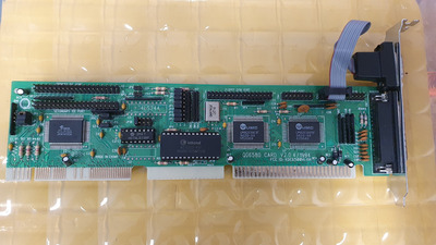

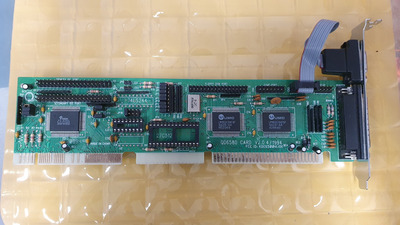

I have both controllers 6500 and 6580 with the XTIDE BIOS installed. After adding the missing components and flashing the BIOS, both work without any issues.
First, I configured the BIOS and then flashed four copies to the EPROM memory.
    1.45 MiB
    250 views
    1.49 MiB
    250 views
    1.87 MiB
    250 views
