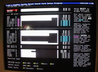

School is over, exams went better than expected (I got B2 in listening and reading, and B1 in writing and speaking), and I even had a job interview some days ago. I'll find out if I get to go forward in some weeks but in the meantime, the IO selections stuff is being worked on right now. Current settings are slowly becoming visible, and once I have finished that, I can work on actually changing them. Then I need to work in all the sound tests, proper error handling and a variety of housework tasks but the light is starting to be seen at the end of the tunnel ~
Mixer is also actually finished now, with SB mixer locking implemented as the last missing thing. That is available only on my card, not generic ones since it is done externally to the YMF71x chip. This ensures games won't mess with the volume levels or have access to the broken master volume of the card which must be at a specfic setting or other levels become ineffective.

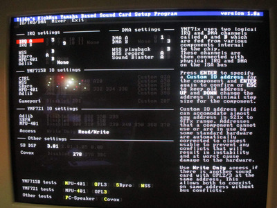

Things go a bit slower than expected but the hardest stuff is starting to get done :
573.4 KiB
555 views
Things left to do :
*Sound tests
*Graceful error handling
*Configuration save/load
*EEPROM management
*Proper testing on generic YMF71x cards aswell as T-04YBSC

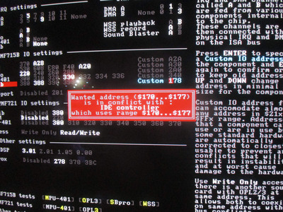

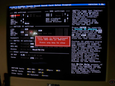

There are working sound tests now, or well, all but SB, WSS and Covox. I'll have to figure out how I'm supposed to do interrupt handling properly and only then I can add those too. I also need to add proper error handling and few other things but the end is starting to get nearer and nearer ~

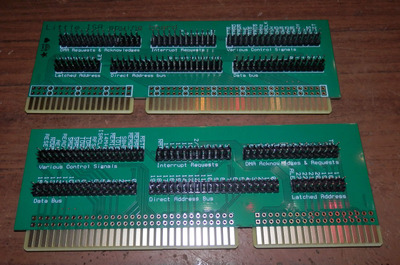

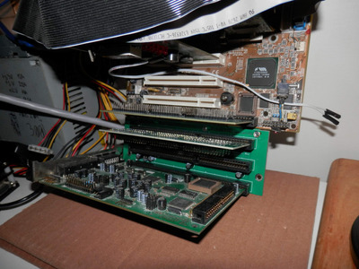

Yesterday I soldered together some little boards to allow me to spy on the ISA bus to see exactly what SETUPSA does, because there are reports of some incompatibilites that go away with SETUPSA.

Reply 358 of 364, by 640K!enough
Tiido wrote on 2025-02-12, 09:54:
That is something I have wanted to do for quite a while. How are you collecting the data? Do you have some sort of expensive logic analyser, or a more creative solution?
I'm still planning on working on a more limited solution to that problem for my purposes (as always, my budget is the main impediment), but it's interesting that you may have solved it already.
Also, how are you implementing your resource conflict reporting? Do you keep a list of common assignments, or are you actually detecting all hardware actually present in the machine and reporting based on that?
Reply 359 of 364, by Tiido
I hook up my DSlogic U3pro32 to these boards. It isn't exactly cheap but it has definitely the best bang for stuff with 32 signals. I would love more inputs though...
There's no active conflict probing, I only keep a list of address ranges that are in use by base hardware etc. and prevent selecting them + checks for conflicts within the card. It won't know if there's a SB16 at 240 for example.
