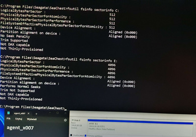

Important part is this :
ALL drives listed were preformatted with 512e mode, NONE came in 4Kn mode by default (even if it was supported).
Example : Seagate Exos X20 20TB drive is 4Kn drive, but I had to manually forced the change to 4Kn using SeaChest utility. I can reformat drive to use sector size 4Kn or 512e [not sure about other ones ones], but to switch between them a full format of drive is required.
Here's how 512n drive (old NVMe SSD), compares to Exos X20 in 4Kn mode :
479 KiB
542 views
4Kn drives in 512e mode should behave the same way as any other 512n drive from OS point of view.
