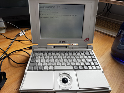

Hello,
I have an ESCOM Paradigma with a 486 DX2 66MHz, 4MB RAM, and a 340MB HDD (Toshiba MK2326FCH) running PhoenixBIOS(TM) A486 Version 1.03.11:
1.08 MiB
456 views
Apart from the fact that the power plug is defective and I have to power the device via the battery pins using a 16V IBM power supply, it actually works quite well.

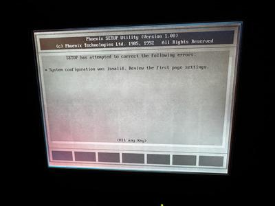

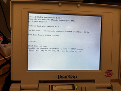

However, it has one issue that I'm not sure how to fix:
Every time I start up the device, I am greeted with this message:
TOSHIBA MK2326FCH
Fixed disk 1 failure
Invalid configuration information - please run SETUP program
Press the F1 key to continue, F2 to run the setup utility
This is extremely annoying because I can't just turn on the notebook and use it. 🙁
I'm wondering what causes this, as the internal HDD is recognized without any problems, and if I proceed with "F1," I can boot from it.
However, if I "misconfigure" the HDD in the BIOS so that it is no longer recognized at boot, I then get this message:
Fixed disk 0 failure
From this, I conclude that "disk 0" is the internal HDD because "disk 0" does not appear in the error message when the "TOSHIBA MK2326FCH" is correctly detected.
But what is "disk 1"? The PCMCIA Slot? The floppy drive?
I have an identical black version of the same notebook here (which does not boot), so I have been able to swap and test various components, including the floppy drive, but this has not helped – the error "Fixed disk 1 failure" keeps appearing.

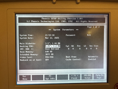

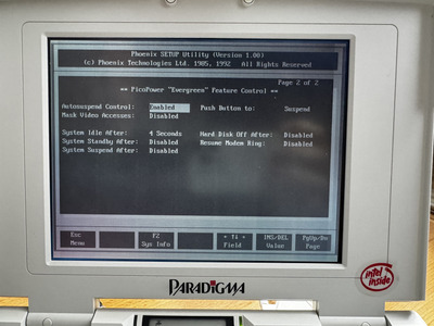

Here are the laptop's BIOS options:
1.09 MiB
456 views
1.08 MiB
456 views
Of course, I have already tried many different settings, but without success.
Has anyone encountered this issue before? Or if anyone has an idea... I'd appreciate any help.

Reply 1 of 16, by st31276a
I only have an idea 😀
A fixed disk is an IDE hard disk in this case, not a floppy drive.
You are right in that fixed disk 0 is the working hard disk.
Somehow it has a primary slave configured too, which it does not seem to find.
Perhaps clearing cmos confoguration data or reloading bios defaults might clear that.

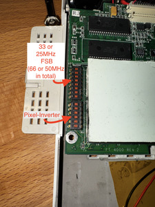

Another thing I noticed is that in 'fdisk,' there's an option under menu item 5 to switch to a second hard drive (if one were present). However, when I try to switch, it says that the drive wasn't found. I've never seen that before, and I'll post a picture of it later.

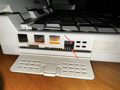

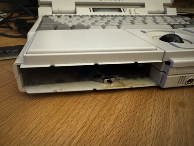

The notebook has several DIP switches located behind a service panel. Maybe one of them is set incorrectly, causing the notebook to think there's a second hard drive. That might explain why I'm seeing the same behavior even after resetting the BIOS settings and replacing the entire BIOS chip.
Here you can see the switches (some are behind another cover):
783.83 KiB
402 views
(Of course, I don’t have any documentation for these switches… 😒)

Reply 7 of 16, by User5518

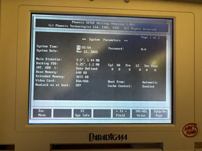

My Test Results:
The DIP switches did not change anything except for the FSB and the inversion of the pixels:
862.89 KiB
355 views

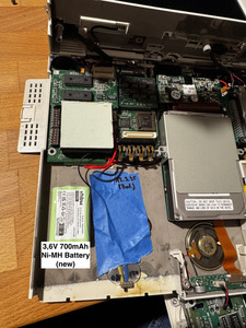

A fully charged CMOS battery was not the solution either. I also had a new 3.6V Ni-MH battery (with a modest 700mAh), but even this CMOS battery made no difference.
1.11 MiB
355 views
Still the same issue:
1.03 MiB
355 views
It is highly unlikely that a bit in the CMOS chip has flipped, as I get the exact same error when using the chip from the other notebook.
(In the meantime, I switched to a Seagate ST9655AG with a 524 MB HDD, but of course, that made no difference either.)

The CMOS configuration of the primary two hard drives is quite universal, as many vendors just copied the IBM layout of CMOS memory. Try some generic AT setup utility like GSETUP and check whether it reports a configured slave drive. If yes, try setting the slave drive type to "not installed" with that tool and hope that the mainboard BIOS picks up the change without resetting the whole BIOS settings.

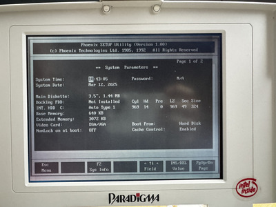

The BIOS is behaving as expected:
I set the HDD to "manual" and entered "0" for each field. Additionally, I assigned a drive to the external FDD port, even though no such drive exists:
1.21 MiB
334 views
Before
Both settings were displayed as expected after a short power-off:
1.09 MiB
334 views
After

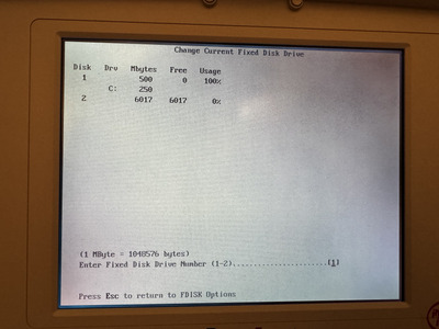

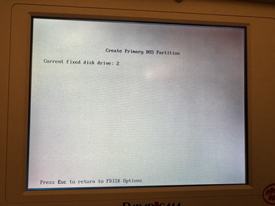

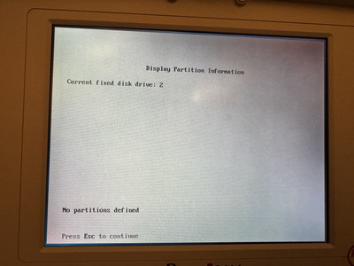

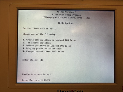

Here is the FDISK view with the 5th option that I mentioned earlier:
1.36 MiB
329 views
1.63 MiB
329 views
1.73 MiB
329 views
1.61 MiB
329 views
When I try to create a partition on this "second" harddrive, FDISK freezes.
@mkarcher I will try this and will report back, thank you.

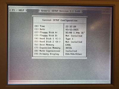

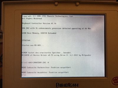

@mkarcher THANK YOU!!!
gsetup solved my issue, it is working!
1.39 MiB
311 views
I was able to disable the second HDD using this handy tool:
1.92 MiB
311 views
My BIOS accepted the change, so I no longer receive that annoying message. Additionally, FDISK no longer detects the "second" HDD. 😀
Now, I just need to 3D-print a small cover for this, and then the notebook will be complete!
