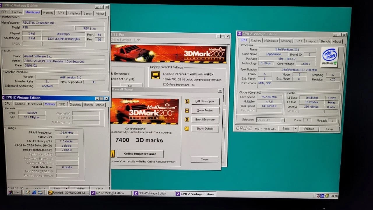

Reply 27 of 29, by dm-
my P2B running 3x256mb sticks @ 133mhz and P3-1000/133 SLOT1 cpu with GF4ti4200.
but not a regular board, had to do some necessary mods.
Reply 28 of 29, by Sly_Botts
dm- wrote on 2025-03-21, 06:19:
https://i.ebayimg.com/images/g/7~8AAOSwtWZnyZEB/s-l1600.webp […]
Oh do tell! I have this board and cannot OC it to 133fsb.
