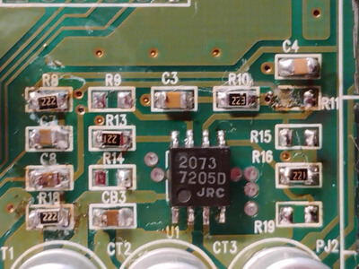

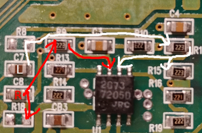

I'm attempting to bypass this card's amplifier so it doesn't sound so terrible. At first I thought it would be straightforward, moving the resistors from R9 and R11 to R8 and R18 but that resulted in no audio output at all. I'm tempted to just desolder all of these SMD components around the amp chip and run a wire straight from pins 50 and 51 on the ES1868F to the output jack but I'd like a more elegant solution.
