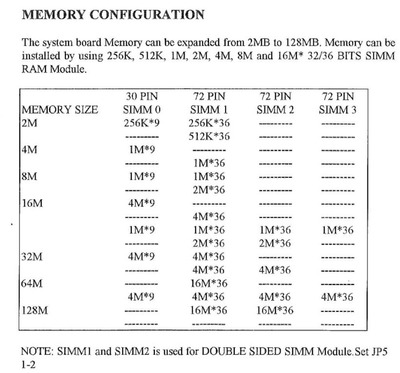

Hello, I recently purchased a new Edom/WinTech MV035F motherboard and I am able to run it with 64MB RAM, however the manual and specs state it can support 128MB RAM with two 72-pin 64MB 16M*36 memory modules.
So I purchased 2 72-pin modules from Memory Masters and installed them in Bank1 and Bank2 the when the system boots it counts 66MB RAM and stops counting and DOS loads but it is very unstable and crashes.
I tested each module individually with Speedsys and each one seems to be fine. When either one of these modules is installed in Bank1 the system counts 65535KB RAM.
Changing BIOS settings has not helped.
Also I know that the RAM slots work because to get 64MB RAM working I had to populate the 4x30-pin RAM slots with 4MB modules (16MB) and populate the remaining three 72-pin slots with 16MB RAM modules for a total of 64MB.
Note, all memory in the current config is single sided but the 72-pin 16*36 modules are double-sided.

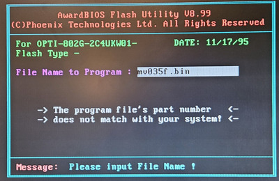

Note, I tried to flash the BIOS but I get the dreaded error "The program file's part number does not match with your system!"

jakethompson1 wrote on 2025-04-26, 00:26:
Many VLB boards do not have a Flash BIOS, rather, you purchase and program another BIOS chip using a hardware programmer and then swap it.
Thank you for that information.

It might actually be slower with 128MB of RAM if the maximum cacheable range the chipset supports is significantly smaller than 128MB. No idea if this is the case here.
